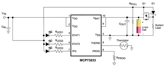

Charging lithium battery while at the same time trying to use circuit didn’t quite workout, with problems like the circuit not turning on and the battery never finish charging.
The battery is 3.7V and capacity of 300mAH.
However I found the microchip app note on same issue.
Here is circuit:-enter image description here
When USB power is applied at Vin this circuit will turn off Q1, and then the load will instead use power from USB through D1. This allows the battery to charge normally without any outside disturbances.
  • The Q1 is P channel MOSFET, but I am not able to understand the connection. Why source is connected to load and Drain connected to Vbat? It should be reverse.
  • Which MOSFET should I select for this circuit? If my Load Current is 100mA max? What should be the Rd (on) and VGS(th) of the MOSFET which I can use in above circuit? Any suggestion for the part number
I am considering this P-Channel MOSFET DMP1045U http://in.element14.com/diodes-inc/dmp1045u/mosfet-p-ch-w-esd-12v-sot23/dp/2061526
I am considering Diode B130LAW :- http://www.farnell.com/datasheets/887879.pdf?_ga=1.83230549.251839788.1488841003
Also D1 is to prevent current flowing from the battery into the charging power source. D1 should be a schottky diode. The reverse leakage current of D1, which could be up to a few hundred microamp (schottky diodes are very leaky).
  • This leakage current will create a small voltage at the MOSFET gate which, if high enough, could cause the MOSFET to not turn back on properly when the main Vin power is removed. How to overcome this?
  • How to minimise the leakage current of D1?
  • What should be the Value of Rpull ?

    What Abe said - but that is a VERY low Vgsth MOSFET. 500 mV is exceptionally good in most applications. As Abe says - see what diode voltage is with choasen Rpull. Do note that Schottky leakage is oftem IMMENSELY higher at say 100C than 20C. If there is any chanfce of elevated temperatures check diode spec at Tmax. – Russell McMahon Mar 19 '17 at 10:53
Why is the MOSFET source connected to load and drain to battery?
As shown in the schematic, the MOSFET has a body diode connected from drain to source. If the MOSFET were attached the other way around, USB power could flow through D1 and the body diode into the battery, charging it faster than is safe. (Note that when is MOSFET is on, it allows current to flow in either direction, like a resistor.)
How to prevent leakage current in D1 from turning off Q1?
Basically, make RPULL strong enough. If your maximum leakage current over temperature and voltage is, say, ILEAK = 100 μA, then an RPULL of 1 kΩ would give a maximum gate voltage of 100 mV, which is almost certainly fine.
What MOSFET should I select?
You are correct that RDS(on) and VGS(th) are the important parameters. You'll need to know the maximum current ILOAD taken by your load. Choose RDS(on) so that even when the battery is almost drained (3.2 V) and the load is drawing maximum current, there will be sufficient voltage for the system. This voltage would be 3.2 V - ILOAD * RDS(on).
You want the MOSFET to be fully on even when the battery is almost drained, so use the same value as above for the source voltage. The gate-source voltage will be the difference between this and the voltage on the gate caused by leakage through RPULL, for a final result of 3.2 V - ILOAD * RDS(on) - ILEAK * RPULL. (Note that a MOSFET is not fully on when at its threshold voltage: you usually want at least a volt extra, but check the datasheet.)
How can I reduce the leakage current?
Keeping D1 cool will help a lot: if you only need to operate up to, say, 50 °C, you'll have a much lower leakage current than at 125 °C (but do take into account self-heating if you're dissipating substantial power in D1). If that's not an option, you can also look at using a regular silicon diode instead of a Schottky. The voltage drop will be much higher, but since you're starting from USB voltage instead of battery voltage, you can afford to waste some.

  • The load current will not exceed 50mA in any case. I am considering this P channel MOSFET : http://in.element14.com/diodes-inc/dmp1045u/mosfet-p-ch-w-esd-12v-sot23/dp/2061526. Will it work? – RS System Mar 19 '17 at 09:59
  • @RSSystem Looks fine to me. At that low of current, though, you could almost certainly get away with a cheaper (= higher resistance) one. – Abe Karplus Mar 19 '17 at 10:07
  • As you mentioned that, Choose RDS(on) so that even when the battery is almost drained (3.2 V), At what VGS, I choose RDS(on)? In data sheet there are different value for Rds(on) on different VGS. What will be the value of VGS when the circuit will be powered by battery and when with USB? Please clarify. – RS System Mar 19 '17 at 12:43
  • @RSSystem A lower Rdson is never going to hurt, just cost more, so make sure that the voltage drop is acceptable for all values of Vgs (and since Rdson decreases with larger Vgs difference, you only have to check at the smallest voltage that will occur). The MOSFET won't be on when powered by USB, so you only need calculate for when battery-powered. – Abe Karplus Mar 19 '17 at 20:07
  • @RSSystem As to the diode you looked at, it has a huge leakage current (1 mA at ambient, so several mA at higher temperature), and you don't need anything like that current-carrying capability, so look at something like the DB2J30900L from Panasonic. – Abe Karplus Mar 19 '17 at 20:16
  • I understand, may be I overlooked the leakage current. The MOSFET I choose is okay? – RS System Mar 19 '17 at 20:42
  • @RSSystem Like I said, the MOSFET looks fine. – Abe Karplus Mar 19 '17 at 20:43
  • The Leakage current of the diode which you suggested, has 0.2uA at Vr= 10V, if 1K Rpull is used, then the Voltage will be 2mV which will not turn on the MOSFET in any case, because MOSFET requires atleast 0.3V to turn on. Am I right? 1K Rpull is enough ? I am unable to understand this equation 3.2 V - ILOAD * RDS(on) - ILEAK * RPULL,what will I get with it and what is the target parameter to meet with this equation. – RS System Mar 19 '17 at 21:43
  • @RSSystem Vgs is the difference between the gate and source voltages, but the 2 mV you calculated is between the gate and ground. – Abe Karplus Mar 19 '17 at 23:19
  • So what should be the value for Rpull with the diode you mentioned? – RS System Mar 20 '17 at 08:15
  • @RSSystem You still haven't said what the maximum temperature you need to operate at is, and since the leakage is so temperature-dependent, the necessary value of Rpull is as well. That said, if you don't care too much about the wasted power when USB is present, 1 kΩ is a very strong pulldown, so would be likely to work. – Abe Karplus Mar 20 '17 at 08:40
  • The temperature at which I need to operate is 20-30C. – RS System Mar 20 '17 at 08:43
  • @RSSystem Then you're not going to get more than about 0.3 μA leakage, so I'd be comfortable taking Rpull as high as a few hundred kΩ if necessary. – Abe Karplus Mar 20 '17 at 09:14
  • I have this MOSFET :http://in.element14.com/infineon/irlml6401trpbf/mosfet-p-micro3/dp/1463267
    and this Diode right now : http://in.element14.com/stmicroelectronics/bat46/diode-schottky-small-signal/dp/9801456 Will they work? If they work, will there be any change in value of Rpull? The diode you mentioned I need to purchase that and MOSFET as well and I need to build this design urgently, so ordering new components will take time and will be difficult to get shipped in short time.
    – RS System Mar 20 '17 at 21:03
  • @RSSystem I don't see any issues with those components. The leakage is a bit higher (0.8 μA), so probably keep Rpull to no more than 100 kΩ and you should be fine. – Abe Karplus Mar 20 '17 at 22:21
