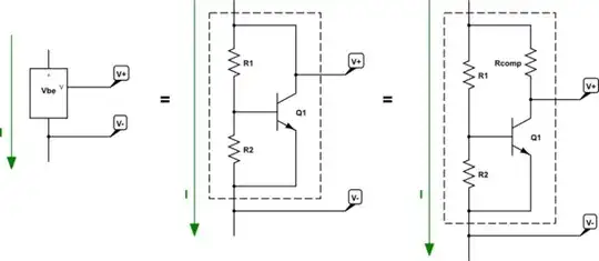

I'd like to somewhat simplify the schematic you've got, so that we can temporarily avoid having to continually discuss the potentiometer when the real purpose is supposed to be trying to understand the circuit:
In the above, I've provided a behavioral model on the left side. It's followed up on the 1st order BJT \$V_\text{BE}\$ multiplier topology without compensation for varying currents through the multiplier block in the middle example. On the right, is a 2nd order BJT \$V_\text{BE}\$ multiplier topology that includes compensation for varying currents through the block.
Everything starts by analyzing the middle schematic. How you analyze it depends upon the tools you have available for analysis. One could use the linearized small-signal hyprid-\$\pi\$ model. But that assumes you fully understand and accept it. So, instead, let's take this from a more prosaic understanding of the BJT model that neglects any AC analysis. Instead, let's take it entirely from large signal DC models and just compare "nearby" DC results to see what happens.

(I just noted where that capacitor is sitting in your diagram. I think it should be between the collector and emitter. But who knows? Maybe I'm wrong about that. So let's leave that for a different question.)
Usual \$V_\text{BE}\$ Multiplier Equation
This will be a very simplified approach, for now. (The model here will need adjustments, later.) We'll assume that the bottom node (\$V_-\$) will be grounded, for reference purposes. It doesn't matter if this node is attached to the collector of a VAS and the actual voltage moves up and down in a real amplifier stage. The purpose here is to figure out the \$V_\text{BE}\$ multiplier voltage at \$V_+\$ with respect to \$V_-\$.
Note that the base voltage of the BJT, \$V_\text{B}\$, is also exactly the same as \$V_\text{BE}\$. So \$V_\text{BE}=V_\text{B}\$. I can use either one of these for the purposes of nodal analysis. I choose to use \$V_\text{BE}\$ as the name of the node at the BJT base. The simplified equation is:
$$\frac{V_\text{BE}}{R_1}+\frac{V_\text{BE}}{R_2}+I_\text{B}=\frac{V_+}{R_1}$$
(The outgoing currents are on the left and the incoming currents are on the right. They must be equal.)
We also have a current source. I'll call it \$I_\text{src}\$. For the middle circuit above, part of that current passes through \$R_1\$ and the rest of it passes through the collector of \$Q_1\$. The base current is the collector current (\$I_\text{C}=I_\text{src}-\frac{V_+-V_\text{BE}}{R_1}\$) divided by \$\beta\$. Given \$I_\text{B}=\frac{I_\text{C}}{\beta}\$, we can rewrite the above equation:

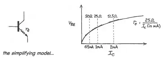

One useful simplification is to imagine that there is a tiny resistor sitting inside of the BJT and located just prior to its emitter terminal:
(Both of the above images were borrowed from page 193 of "Learning the Art of Electronics: A Hands-On Lab Course" by Thomas C. Hayes, with assistance from Paul Horowitz.)
The above concept represents the dynamic resistance, which is just the local slope along a non-linear curve.
This resistor is called \$r_e\$ and its value depends upon the emitter/collector current magnitude. You will see it as either \$r_e=\frac{V_T}{\overline{I_\text{C}}}\$ or as \$r_e=\frac{V_T}{\overline{I_\text{E}}}\$, where \$\overline{I_\text{C}}\$ and \$\overline{I_\text{E}}\$ are some assumed mid-point on the curve around which those currents vary. It doesn't really matter which you use, because modern BJTs have rather high values for \$\beta\$. So let's not fret over minutia and instead just assume \$r_e\$ is a function of the collector current.
Note: In the following, I will continue to follow above book's approach in calling this \$r_e\$, despite it being based upon the
collector current. In various literature, it may be denoted as
\$r_e^{\,'}\$ and it may be based upon the emitter current, instead,
as well. But for these purposes here, I intend to remain consistent
with the above book's approach.

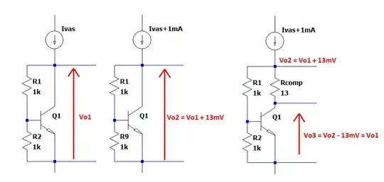

Which is just what G36 mentioned as the effective resistance for the middle schematic.
Adding a Collector Resistor to the \$V_\text{BE}\$ Multiplier
Now, keep in mind that the collector current does in fact vary, in operation. Perhaps like I mentioned above. Perhaps more. Perhaps less. But it does vary. How important that is will depend on your schematic and your design choices. But let's assume it is important enough that you are willing to consider adding a cheap resistor to the collector leg as shown in the schematic on the right, above. (You've been told that this is a "good idea.")
Why is this a good idea? Well, at first blush it should be easy to see that if the collector current in the middle circuit increases then the \$V_+\$ increases by some small amount. But what if we added a collector resistor? Wouldn't that mean that if the collector current increased, that the collector voltage itself would drop because of the change in the voltage drop through the collector resistor? Does this suggest to you that if you could pick the right value for this collector resistor, then you might be able to design it just right so that the increased drop across it just matched what would otherwise have been an increase in \$V_+\$ in the middle circuit?
If you agree with that logic, can you also now work out how to compute a value for \$R_\text{comp}\$ that would be "just right" and then compute the new effective resistance of the new circuit?
Just think about this for a moment. You have a \$V_\text{BE}\$ multiplier here and you know the approximate equation used to compute its voltage. But this equation doesn't take into account the fact that \$V_\text{BE}\$ changes when the collector current changes. The value of \$r_e\$ (at some design value for the collector current) is the tool that helps you quantify the change in  \$V_\text{BE}\$ for changes in the collector current. And you know that the  \$V_\text{BE}\$ multiplier will multiply that change, too. So if the collector current increases (because the upper quadrant stops requiring base drive current, leaving all of the current source's current to flow through the multiplier), then the multiplier's voltage will increase by the multiplied change in drop across \$r_e\$. To counter this effect, you want the collector resistor's voltage drop to likewise increase by just that same amount.
So, does that help you think about how to compute the collector resistor value? As a first approximation, wouldn't you want the value to be about \$R_\text{comp}\approx r_e\left(1+\frac{R_1}{R_2}\right)\$ so that when the change in collector current creates a multiplied change in \$V_\text{BE}\$ that the drop in this newly added collector resistor will just match up with it?

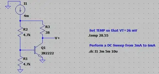

Suppose we make the collector resistor exactly equal to this above-computed total resistance. Namely, \$R_\text{comp}=38\:\Omega\$. The reason is that we expect that the change in voltage drop across \$R_\text{comp}\$ will just match the increase/decrease in the \$V_\text{BE}\$ multiplier as both are then equally affected by changes in the collector current due to changes in \$I_\text{src}\$. (We have so far avoided directly performing a full analysis on the right-side schematic and we are instead just making hand-waving estimates about what to expect.) Given the prior estimated impedance and this circuit adjustment used to compensate it, we should expect to see almost no change in the voltage output if we used the right-side schematic.

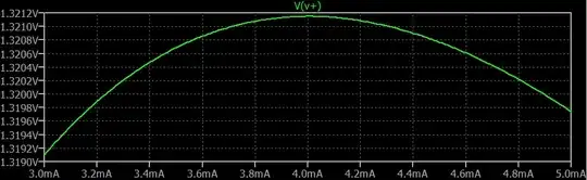

Here is the LTspice's schematic I used to represent the right-side, compensated schematic:
And here is LTspice's plotted analysis of the \$V_+\$ output using a DC sweep:
Note how well the output is compensated! Note the peak is located almost exactly where our nominal value for \$I_\text{src}\$ is located, too?
The idea works! Both in terms of being compensated exactly where we want that compensation as well as in providing pretty good behavior nearby. Not bad!!!
