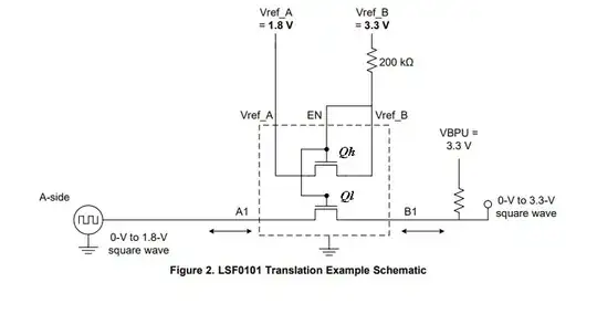

I tried to simulate my circuit with ngspice (through Kicad) and SimulIDE, but I can't get something that resembles how the LSF should behave: as a closed switch on LOWs and open if both sides are HIGH (if I understand that correctly). The guide says it's basically two FETS with connected gates, the top one connected to VrefA and VrefB and the bottom one to input/output pins. But I can't find a Spice model, I can't reproduce it (maybe because I don't have the FETs' properties or the real circuit is more complex), and I really don't understand how it's supposed to work.

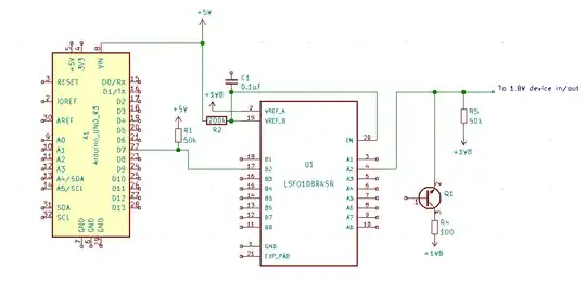

Here's a simplified schematic if it helps (don't mind the BJT, it's for another question).
Arduino to eMMC simplified schematic

Here is an LSF block diagram from fig 2 in the TI Application Report that you cited.
I'll explain a left to right signal transfer and leave you to go from there.
The two FETs are provided to implement a switch that operates when the levels are AT a desired voltage, unaffected by Vgsth = FET gate threshold voltages.
VrefB is > Vrefa - typically at least 1 V higher (spec sheet says).
Example: A-side = Vin.
B-side = Vout.
VrefB pulls up Qh drain & (connected) gate via 200k.
As Qh turns on stabolises when Qhd / Qhg is Vgsgth_Q2 above Qhs = Vrefa.
ie gate voltage is at critical turn on voltage of FET when FET s is at Vrefa.
BUT Qhg is connected to Qlg so Ql also "just" turns on when Qls is at Vrefa.
So Ql is thus biased to turn OFF when input rises to or above Vrefa and to turn on when Vin falls below Vrefa.
SO -
Vin high:
When Vin A side is at Vrefa FET Ql is off and Q1d= B out is disconnected from Vin and so Vout is pulled up by VBPU to 3V3.
Vin low
When Vin is puilled low to ground, Ql is on (as QLs below Vrefa) so Ql is on so Vout is pulled low (to ground) so Vout is low when Vin is low.
The LSF series allows different translation voltages on the B side channels by using different pullup voltages on the B side lines.

  • Thanks for the detailed answer. :) I understand the Sparkfun circuit in your first link with the BSS138. I think I'm getting how the LSF works: the top FET creates a feedback loop, and that sets Qlg to the voltage we want. Then the bottom FET works like the Sparkfun shifter, only with no requirement on Vth. Is there a diode there too to allow for right to left transfer? – Pik' Jun 06 '19 at 08:50
  • @Pikrass Don't THINK you know. Read through my above description and make sense of each sentence before moving on and you then WILL understand it. – Russell McMahon Jun 06 '19 at 12:29
