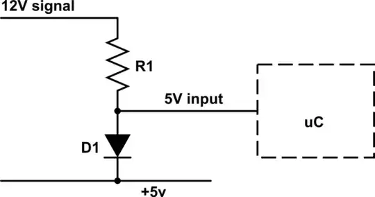

You can also use a diode and a resistor, as follows:
schematic
I'd make the resistor something fairly stiff, otherwise you'll be sinking a lot of power from this circuit. The beauty of this circuit (in comparison to the voltage divider) is that it doesn't care about whether your original voltage is 12V, 14V, or 15V: it will be 5V (actually 5.2-5.3V depending on the diode) regardless of the input voltage.

  • that's quite clever, +1 for voltage independency! – Florian Castellane Jan 14 '17 at 23:44
    Careful with the overvoltage on pin absolute maximum rating. For example, ATmega32u4 datasheet: Voltage on any Pin with respect to Ground(8): -0.5V to VCC+0.5V. If using a regular diode, voltage will be greater than VCC + 0.5V if using anything less than 170kOhm resistor. I think Schottky diodes are the safest for this. – cyberponk Jan 24 '17 at 05:17
  • You should only do this with a Schottky diode. Otherwise the high side ESD diode in the uC will potentially enter conduction before D1 does. They aren't meant for continuous operation. – KevinThibedeau Jul 10 '21 at 17:30
