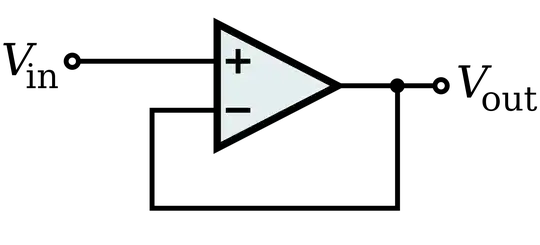

EDIT: Yes, loading of the ADC circuit could be a problem. The easiest way to prevent this would be to connect the large value voltage divider, which I describe here, to the op-amp voltage follower shown below. This would both drop the voltage to a level the arduino can handle, and prevent any ADC circuit loading.

    There is another potential problem. Sometimes ADC inputs can be in the 100's of k range in terms of input impedance. They sometimes have their own voltage dividers inside. When this happens, high value resistor dividers can't be used. The OP should check to see if the ADC input current or input resistance is specified. – user57037 Dec 16 '14 at 04:56
The best thing for you is to use the op-amp buffer. You can read about it here:
http://en.wikipedia.org/wiki/Buffer_amplifier#Voltage_buffer
This is a simple op-amp buffer and can be realized using op-amp 741 IC
The circuit in designing a buffer is just an operational amplifier, nothing else. Although you might consider reducing the 9V to 5V to prevent any damage to the arduino. Here a voltage divider will be useful. So, first use the buffer amplifier(this will avoid loading the input circuit) and then use a voltage divider configuration to convert the 9V to 5V. This should solve your problem.

    I have to take exception to this answer. Where is the power for the op-amp coming from? If it is coming from 9V, then it is loading the 9V circuit. If it is coming from 5V (or 3.3V) on the arduino board, then you cannot use a unity gain follower, because the input is up to 9V. The output will not be able to exceed VCC. If you put a Voltage divider on the input of the op-amp buffer, well, we don't know for sure whether that is any different than putting a divider on the input of the arduino ADC because we don't know the input impedance yet. – user57037 Dec 16 '14 at 19:54
  • @mkeith That's a good exception! However since I am driving my Arduino on a separate 12V adapter, I was thinking of using that to power the Om-Amp. I had in mind using a single power LM358 as a unity gain voltage follower and have a simple resistive voltage divider at its output to source my analog input pin on the arduino. any thoughts on that? – Ameya Dec 17 '14 at 19:04
  • That should work. And as the input impedance of the arduino is way too high, it won't affect the output voltage of the voltage divider network. – Santosh Dec 17 '14 at 19:11
  • @Santosh, what is the actual input impedance of the arduino ADC? – user57037 Dec 17 '14 at 19:14
  • well, searching on the internet tells me that ADC input impedance is typically 100MOhms. – Santosh Dec 17 '14 at 19:17
  • I found it here: http://electronics.stackexchange.com/questions/67171/input-impedance-of-arduino-uno-analog-pins

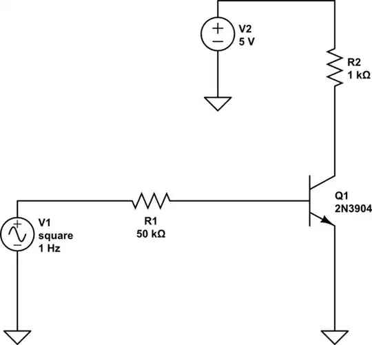

Given your new enhanced description, you should probably be using DIGITAL TECHNIQUES to look for falling edges on your 9V chopped signal. Use the signal to drive the base of a transistor, and a fairly big resistor to current limit that. Power the transistor with 5 Volts.
An optocoupler needs to suck enough current to drive a photoelement, and will probably draw more current than a simple transistor circuit.
Detecting your falling edges is a much more efficient way to deal with all of your issues than sampling of the analog signal.
schematic
If you run this simulation, this is actually inverting, so you would detect rising edges. I used a generic transistor, but a 2n3904 would be fine.

  • This seems to be a great idea! Simpler than buildinga untiy gain OPAmp circuit along with a resistive voltage divider(as I tried to describe in the comment above). Since I want to detect the falling edges, I guess I would need a pnp transistor. Any recommendations, on what value base resistors and which transistors? – Ameya Dec 17 '14 at 19:11
  • @Ameya, I provide an inverting circuit for you in the answer now. – Scott Seidman Dec 17 '14 at 19:56
