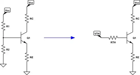

You probably already know about an easy way (cheap, too) to create a new voltage source -- use a resistor divider. So that's what's used. The pair of base resistors forms a Thevenin equivalent voltage and Thevenin source resistance.
The resistor divider allows you to construct a new and useful Thevenin voltage rail out of the main power supply voltage rail:
schematic
Here, \$V_\text{TH}=V_\text{CC}\cdot\frac{R_2}{R_1+R+2}\$ and \$R_\text{TH}=\frac{R_1\cdot R_2}{R_1+R_2}\$. This fact gives you a new degree of freedom in setting up the BJT for some desired DC operation point.

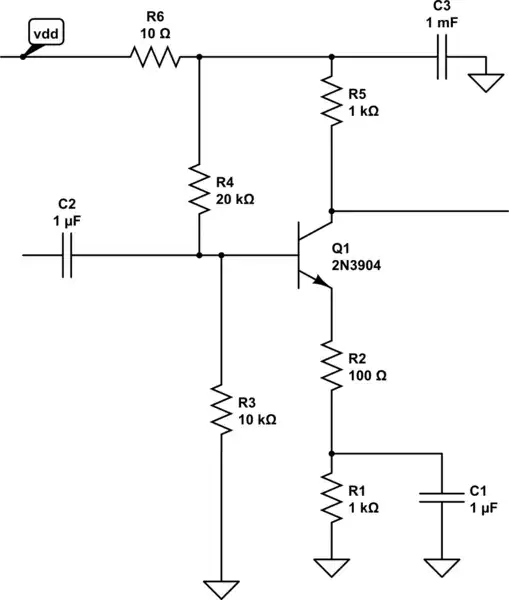

Throw away Rc. As long as the transistor has 1volt across vce, you can view the entire circuit as voltage-controlled current source, with DC and AC variations of the current.
The DC current will be (Vbase - 0.6v)/ Re. If Vdd is 9v, if Vbase is 3v, and Re is 1K, then Idc = (3 - 0.6)/1000 = 2.4 milliAmps.
[To produce Vbase as 1/3 of VDD, have R1 be 2*R2. And to respect the finite BETA, have R2 be 10X Re.]
The AC current will be VinPP / (Re + 1/gm). At 2.4mA, gm is about 0.10 amps/volt, thus ACcurrent is Vinpp /(1,000 + 1/0.1) = Vinpp / (1,000 + 10). By the way, in my personal approach to bipolar design, I call that 10 ohm resistor (which is 1/gm) by the name of "reac" or re_ac, the derivative of the diode equation.
Knowing the currents out of the collector, we can insert a Rc to convert these currents, both fixed and changing, back into voltages. Knowing VoutAC and VinAC, we compute the stage voltage gain.
This circuit, with +9 volts, 20K for R1, 10K for R2, 1K for Re and 1K for Rc, has a very low distortion inverting gain of about 0.990.
If you want gains higher than 1, I suggest this
