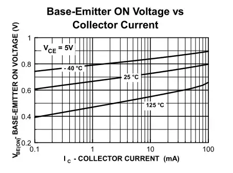

Here is a graph of typical Base voltage vs Collector current for the 2N3904. The curve may look linear, but only because the current axis is logarithmic.

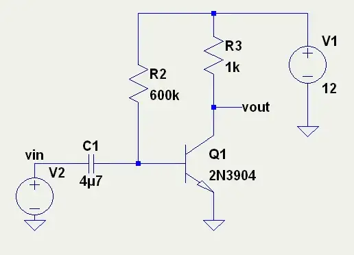

The first circuit I tried is the basic CE amp. It had excellent voltage gain of 46 dB, but the 2nd harmonic was only 16 dB down.

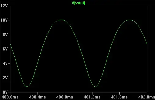

The output waveform was noticeably distorted due to the exponential rise in Base current as Base voltage increases, causing the output waveform to steepen as it goes down (Collector current increasing more).

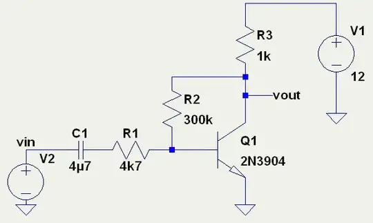

Next I moved the bias resistor to the output to help stabilize the DC operating point, and added a resistor at the input to linearize Base current and produce negative feedback (in conjunction with the bias resistor). This circuit had a reduced voltage gain of 28 dB, but the 2nd harmonic was 35 dB down. Much better!

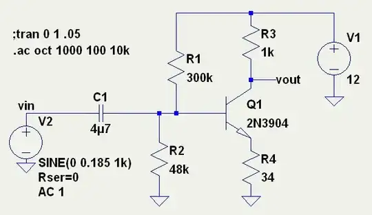

Finally I tried a 4 resistor biasing scheme with Emitter degeneration. This has better DC stability, but maximum output voltage swing is reduced due to voltage drop across the Emitter resistor. It also had a voltage gain of 28 dB, but the 2nd harmonic was a bit more prominent at 32 dB down.
