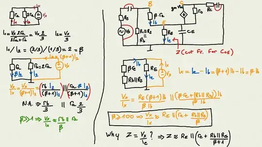

In a lot of reference I see divergence like Zce = RE || (beta re + Rb || Rs) / (beta + 1) etc. $$Z_{ce} = R_E || \left(\frac{\beta.r_e + R_b || R_s}{\beta + 1}\right)$$
See link 1, link 2, link 3, link 4
but from a trivial example I get
Zce = RE || (beta re + Rb || Rs) / (beta) $$Z_{ce} = R_E || \left(\frac{\beta .r_e + R_b || R_s}{\beta}\right)$$
Frequency response of BJT frequencies with CE bypassed
Note : with that, i get the same result than here with the result of Electronic Devices and Circuit Theory, by Boylestad and Nashelsky.
Note : I know with beta >= 100 it is the same but i like to have a rigourous demonstration.
Do you think it is a good reasoning here ?

  • That the correct equation is $Z = R_E|| (r_e + \frac{R_B||R_S}{\beta +1})$ – G36 Jul 24 '20 at 16:28
  • Because in $\beta r_e$ is just an approximation the correct version is $r_\pi = (\beta +1)r_e$ – G36 Jul 24 '20 at 16:30
    $r_e = \frac{dV_{BE}}{dI_E} = \frac{V_T}{I_E}$ https://electronics.stackexchange.com/questions/429716/arriving-at-a-wrong-output-impedance-for-a-bjt-emitter-follower-configuration-ci/429726#429726 – G36 Jul 24 '20 at 16:32
  • Did you notice the mistake in your analysis? – G36 Jul 24 '20 at 18:22

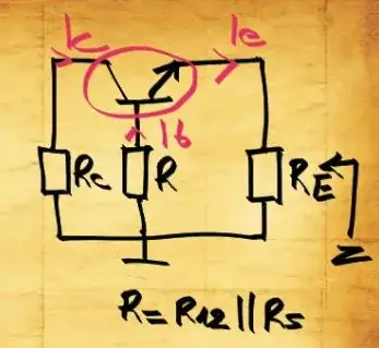

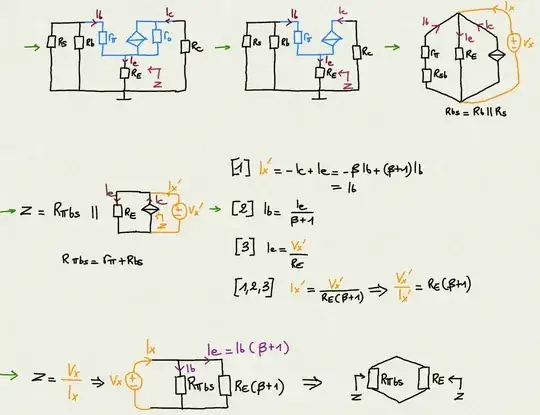

Solution:
  1. The error done is that it is necessary to include all the branches of the current sources (ic was forgotten).
  2. Another error is that since
to get
a bad representation of the current branches which does not respect the transistor (with its currents ie, ic, ib) gives an unusable diagram
[fig. 1] is the good choice.
[fig. 2] it makes no sense.
So the solution is [fig. 1] and you get
thus the calculation of z1 gives
and finally you can give this representation
and for the calculation of Z you do not have to worry about the current flowing in Re nor in Z1.
Likewise, you must remember of considering the BJT with its current on its ports (ie, ib, ic) so make the extensions of the wires with their currents.

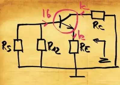

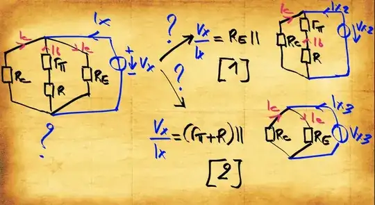

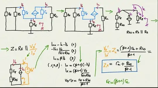

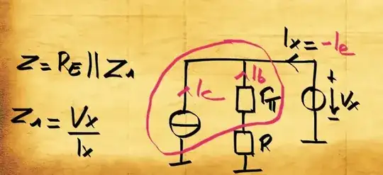

  • Case of a good calculation from RE : put the pen between RE and ie : you'll see it's RE || Z1. In this case, you can calculate Z1 with the branch ib, ic :
  • Case of a bad calculation of Z1 :

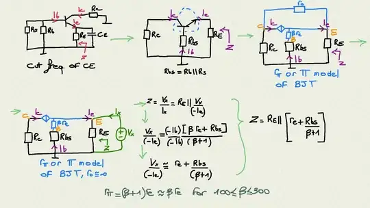

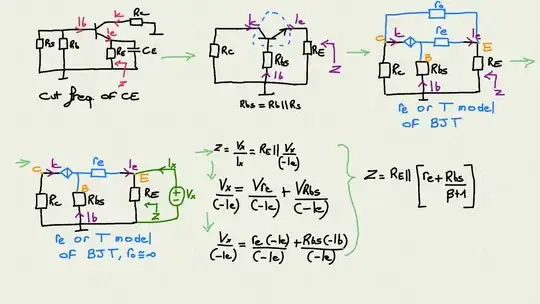

Likewise, the BJT with its current on its ports (ie, ib, ic) so make the extensions of the wires with their currents. In theses pictures you'll see a demonstration with \$ r_e \$ and \$ \pi \$ model.
Demonstration with \$ r_e \$ (or T) model : re model
Demonstration with \$ \pi \$ model (\$ \pi \$ model obtained with the T model) : pi model
