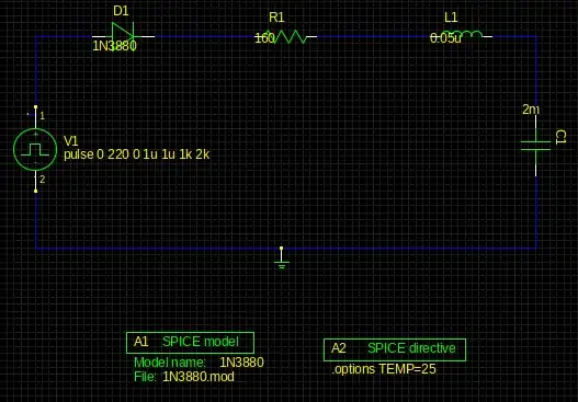

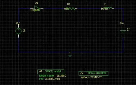

Im trying to do a transient response analysis with ngspice/gnucap and gspice UI of the next RLC circuit (corrected the source polarity), to find the damping effect in the system. enter image description here
That with the next command
 gnetlist -g spice-sdb -o rlc.net RLC.sch

V1 1 0 pulse 0 220 0 1u 1u 1k 2k
.options TEMP=25
C1 4 0 2m
L1 3 4 0.05u
R1 2 3 160
D1 1 2 1N3880
.end

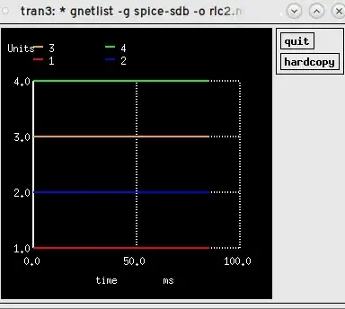

ngspice 65 -> plot 1 2 3 4
Still gives something like this
Still different from what I was expecting for, at this point what I want to see is the current in the resistor. I have updated with a pulse source as suggested, but it still does not work as desired. enter image description here

    From another circuits done, and as commented by @sstobe, the right way to plot would be
    plot v(1)
This indeed plot the voltage 1, the voltage at node 1 and so on... The way i did before I was telling to ngspice to plot the integers 1,2,3.. that's why the graphs.

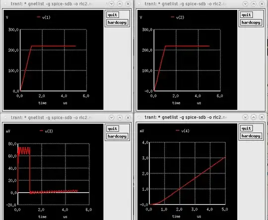

So I adjusted to
tran 0.1us 5us
That finally yield enter image description here but since the idea was to plot the current this could not be done.
