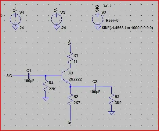

Here is a "real" example from LTspice:
NETLIST
V1 V+ 0 24 Rser=0
V2 SIG 0 SINE(-1.4563 1m 1000 0 0 0 0) AC 2 Rser=0
V3 V- 0 -24
Q1 N001 N002 N003 0 2N2222
R1 V+ N001 1f
R2 N003 V- 2K7
C2 N004 N003 100µF
R3 N004 0 3K9
R4 N002 0 22K
C1 N002 SIG 100µF
PICTURE OF CIRCUIT
Circuit Ex

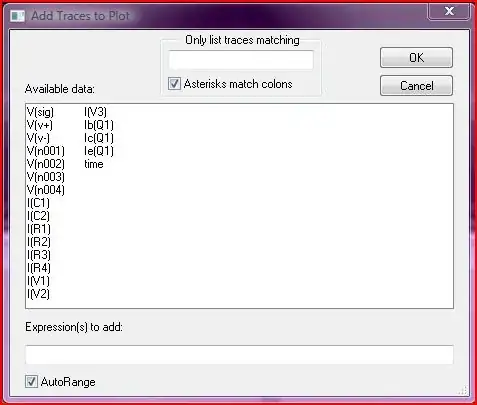

PLOT OPTIONS
(Note that there is no I(n001), I(n002), etc)
