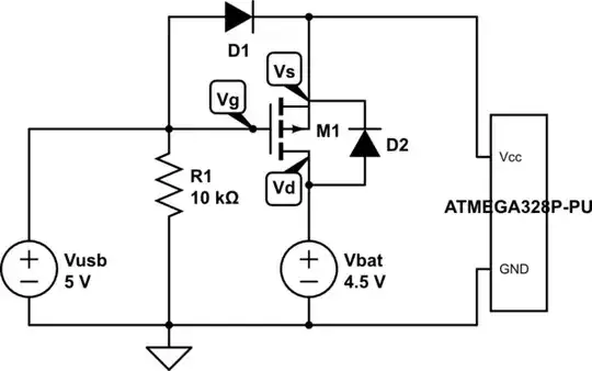

I was close, but this seems to be a working circuit, based on this app note for a load-sharing circuit and this SO question. Essentially, I needed to reverse which side of the MOSFET the load goes on. See below:
schematic
Analyzing this circuit...
When USB is connected, Vs = Vg - Vf1 ==> Vg - Vs = Vf1 = Vgs, where Vf1 is the forward voltage drop across D1. Then D1 can be selected such that its forward voltage falls under the Vgs(th) of the MOSFET, keeping it open. If Vgs(th) is about -2V to -4V (based on a typical logic-level P-Channel MOSFET), then we just need a diode with a drop of less than 2V, which is very easy. We also need to maintain as close to 5V as possible for the ATMEGA chip, so a schottky is best, as it can provide less than 1V drop.
When the USB is disconnected, Vg is pulled to 0V, and Vs = Vcc = Vbat - Rds(on)*50mA (for an approximate 50mA current). Thus Vs is close to 4.5V and Vgs ~= -4.5V, and the MOSFET will conduct. Selecting a MOSFET with a low Rds(on) will keep from losing too much voltage. The D1 diode keeps the gate Vg from being equal to Vs at this point, as it will be reverse biased.
Lingering questions...
  • One part that I'm not totally certain of is the scenario when the USB is disconnected: How can I assume that the MOSFET is conducting? It seems that if I start with that assumption, I don't run into any contradictions. Yet, if I assume that the MOSFET is open and Vs = Vg = 0V, then I don't really run into contradictions either. What would Vs be when in this second case? Perhaps someone can clarify? Otherwise, I'll assume that the folks who wrote the app note I'm referring to know what they're doing.
    UPDATE - Answer: When USB is unplugged, Vg = 0V and Vs = Vd - Vf where Vd = Vbat and Vf is the MOSFET's body diode forward voltage drop, usually around 0.65V (note this is typically specified as Vsd on a datasheet and is usually given as a negative number). This puts Vs ~= 3.85V, resulting in Vgs = Vg - Vs = -3.85V. For a P-Channel MOSFET with a Vgs(th) of -2V to -4V, this will activate the MOSFET and cause it to conduct. Once the MOSFET has turned on, the voltage drop from the body diode goes away, and is replaced by the voltage drop from the internal resistance, called Rds(on), so Vs = Vd - Rds(on)*i where i is the expected current through the MOSFET.
    Side Note: Don't be confused by the fact that Vgs(th) is often a range on datasheets rather than a single value. It's totally fine and often desired to be more negative than the "max" for range (e.g. -4V in our case), within the datasheet's absolute max ratings, of course.
  • Is D2 necessary? If I understand correctly, it keeps current from backfeeding into the battery. The app note pictures it and mentions you can buy the MOSFET with it built-in (schottky). I manually added it to my schematic, but is it already assumed? i.e. is it the same or different from the parasitic body diode?
    UPDATE - Answer: It is the same as the body diode of the MOSFET and is not required as an "extra" diode. That said, some have recommended against using it as the only backward-current protection diode.

    The source of the PMOS should connect to the higher voltage (Vbat) rather than the lower voltage (Vcc). The symbol is shown correctly but your labels for Vs and Vd are reversed. When USB is connected Vg=Vusb so Vgs=Vusb-Vbat. When USB is not connected Vg=0 and Vgs=-Vbat. You are wasting a lot of power in R1...I would use 1k$\Omega$ or so. – Elliot Alderson Jan 22 '19 at 15:31
  • @ElliotAlderson Ah, you're right. I also meant to make the resistor a 10K. I was in a bit of a rush posting this morning... Thanks. – Andrew M. Jan 22 '19 at 17:42
  • @ElliotAlderson It's corrected. Any comments appreciated! – Andrew M. Jan 22 '19 at 17:46
    D2 is the body diode of the MOSFET; you don't need to add it as a discrete part. Btw that same diode might be important for the proper operation of the circuit at the moment the USB power is removed. It will take some miniscule time for the gate charge to dissipate through R1 (few microseconds probably), but during that time the MCU would only be powered from Vbatt through D2. When Vg gets to 0V, the P-MOS will conduct as expected. Be sure to have some more capacitance on the power supply pins of the MCU, 1µF or so, to cater for such transients. – anrieff Jan 23 '19 at 02:14
  • Thank you @anrieff! Any thoughts about the first bullet? Namely why I can assume that Vs is not zero while the USB is disconnected. – Andrew M. Jan 23 '19 at 02:28
  • For the same reason: Vd = Vbat, then Vs = Vd - 0.65V (the Vf of the body diode). – anrieff Jan 23 '19 at 02:35
  • @anrieff That makes sense. However, that’s just for determining whether the MOSFET will close right? Once closed and conducting, the voltage drop across the S-D channel is determined by Rds(on) right? – Andrew M. Jan 23 '19 at 02:54
    That's correct. Be sure to select a MOSFET with low enough Rds(on) at the Vgs you'd be having - around -4.5V. – anrieff Jan 23 '19 at 03:00
  • @anrieff I’m looking at the FQP27P06 by On/Fairchild as it seems popular for logic-level applications. Anything jump out that could be unfitting? One concern I have is that it says Vds is up to -4.0V! If I understand right, that could put Vs at nearly 0.5V and keep the MOSFET from closing right? (as it would give a Vgs of -0.5V and that’s far under the stated Vgs(th) of -2V to -4V...). I’d also be curious to know if this would need the extra capacitor you mentioned, as it’s stated to be fast for similar applications as mine. – Andrew M. Jan 23 '19 at 03:39
  • FQP27P06 is not really logic level, it is optimized for being driven at Vgs = -10V. It would likely work, but the Rds(on) would be higher compared to a true logic level MOSFET. Better alternatives (e.g. IRLML6402) exist. As per the cap on the MCU - you need to have some anyway, e.g. 100nF, but having more would be better when you know the power supply can have small transients like this. – anrieff Jan 23 '19 at 13:03
  • @anrieff Where did you get the 0.65V drop a few comments above? Could you elaborate on where in the datasheet it came from? If it was the graph, I’m a bit confused as the graph doesn’t line up with the 4V mentioned in the sheet for Vsd at the tested current. (Also, the MOSFET I mentioned actually has a pretty low Rds(on), at least for me). – Andrew M. Jan 23 '19 at 15:45
    A silicon diode has a typical forward voltage of about 0.65V, and of course that depends on the current thru it and temperature. The body diode (D2) is one silicon diode. It's exact characteristics in the FQP27P06, can be seen in Figure 4 on the datasheet ("Body Diode Forward Voltage Variation"). But the point is, if your P-MOS is off, Vs cannot be less than (Vd - 0.65V) (if it is, the body diode conducts). If the P-MOS is on, then Vs ≅ Vd (only resistive losses remain). – anrieff Jan 23 '19 at 16:32
    This is of course all greatly simplified and a lot of assumptions are made. I'd recommend you to get a nice circuit simulation tool (Circuit Lab on this site; or Falstad, or LTspice) and simulate the entire thing, I believe a lot of things will become more clear once you see them in action, and visualize the voltages at the various nodes. – anrieff Jan 23 '19 at 16:35
