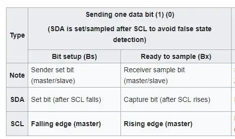

I found this from wikipedia page. It says, data is sampled after SCL line rises.

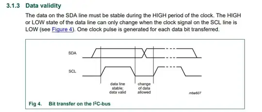

To be a bit more precise, the data isn't just sampled at the rising edge, but must change before the rising edge and be stable for the entire HIGH period of the SCL.
Data Validity
This screenshot was taken directly from the I2C Specification.

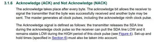

Note: The ACK bit must follow this as well:
