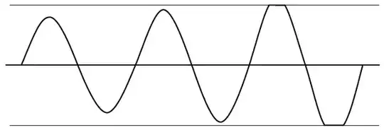

If \$|A\ \beta| > 1\$, then the oscillator will drive itself into saturation and clip the output waveform. The amplifier is an operational amplifier with \$\pm\$ power rails. The amplifier cannot drive the output past the power rails.
Unstable Oscillator
The gain and attenuation are not stable and the amplifier output increases to the power rails of the amplifier. If it is a sine wave oscillator, the output increases until the amplifier saturates, and it is no longer a sine wave. Tops get clipped.

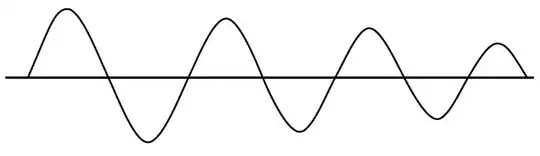

If \$|A\ \beta| < 1\$ the oscillations will fade out. This is called damping.
Damping
