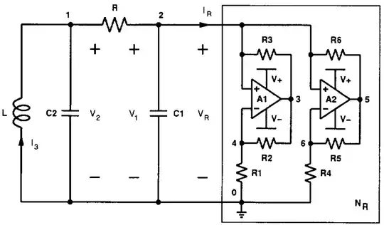

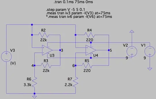

Chua's circuit is one of the simplest circuits known to exhibit chaotic behavior. It consists of resistors, capacitors, an inductor, and an active nonlinear resistor. One implementation of this nonlinear resistor is given in the figure below of Chua's circuit from Kennedy's 1993 paper: enter image description here
I simulated this nonlinear resistor in LTspice...

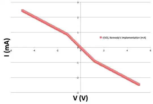

... and measured its current-voltage (I-V) characteristics by sweeping V (\$V_R\$ in Kennedy's circuit) from \$-5\text{V}\$ to \$+5\text{V}\$ and measuring the current output through V3 (\$I_R\$ in Kennedy's circuit). All component values were chosen to match those in Kennedy's paper. My results are shown below (and match the results reported by Kennedy, not shown):
Mathematically, the I-V characteristics of this nonlinear resistor are given by:
\$I_{R} = \begin{cases} -0.409V_{R} + 0.409, & V_{R} < -1.3 \\ -0.750V_{R}, & -1.3 \geq V_{R} < 1.3 \\ -0.409V_{R} - 0.409, & V_{R} \geq 1.3 \end{cases}\$
where \$V_R\$ is in volts and \$I_R\$ is in milliamps.

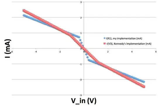

Comparing the current through the load R1 in the circuit with my nonlinear resistor to the current through V3 in the circuit with Kennedy's nonlinear resistor, we find that they are a close match:

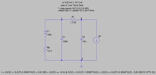

Next, to test that current outputted by my nonlinear resistor still induces chaotic behavior in Chua's circuit, I simulated Chua's circuit in LTspice, replacing the nonlinear resistor with an ideal current source whose output is given by \$V_{out}\$ (defined above) times the gain of \$-0.245\frac{\text{mA}}{\text{mV}}\$ (calculated above). This results in the following piecewise linear formula for \$I_{out}\$:
\$I_{out} = \begin{cases} -0.306V_{in} + 0.613, & V_{in} < -0.4 \\ -1.839V_{in}, & -0.4 \geq V_{in} < 0.4 \\ -0.306V_{in} - 0.613, & V_{in} \geq 0.4 \end{cases}\$
where \$V_{in}\$ is in volts and \$I_{out}\$ is in milliamps. This circuit is shown below, where all component values and initial conditions were chosen to match those in Kennedy's paper (R8 is a necessary parasitic resistor) and the output of the ideal arbitrary current source B1 is given by I = ((V(2) < -0.4)*(-0.3064*V(2) + 0.6128) + ((V(2) >= -0.4) & (V(2) < 0.4))*(-1.8385*V(2)) + (V(2) >= 0.4)*(-0.3064*V(2) - 0.6128))*(10**(-3)) at the bottom of the figure.

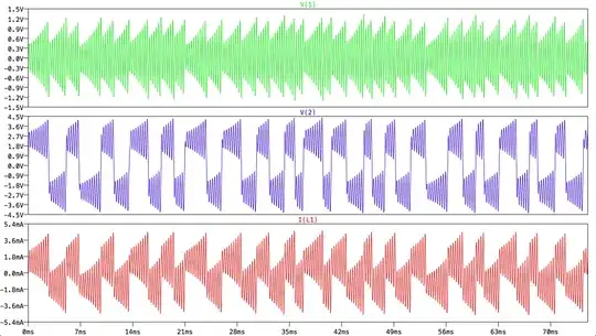

The circuit does indeed exhibit chaotic behavior, despite the approximation made to Kennedy's nonlinear resistor:

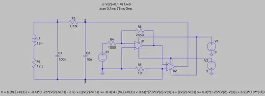

Now, we get to the puzzle. To integrate my nonlinear resistor into Chua's circuit, I substituted my nonlinear resistor for the ideal current source to obtain the circuit shown here:
The voltage outputted by the arbitrary voltage source B1 represents the output of the saturating transformer. Its value is given by the piecewise linear formula for \$V_{out}\$ shown at the bottom of the figure (V = (((V(2)-V(3)) < -0.4)*(1.25*(V(2)-V(3)) - 2.5) + (((V(2)-V(3)) >= -0.4) & ((V(2)-V(3)) < 0.4))*(7.5*(V(2)-V(3))) + ((V(2)-V(3)) >= 0.4)*(1.25*(V(2)-V(3)) + 2.5))*(10**(-3))). Note, however, that because the node below C2 (node 3) is no longer grounded, the output of B1 is a function of the difference between the voltages at nodes 2 and 3.
I ran the same simulation the one as above (with the ideal current source) and got a completely different result, shown below:
I am confused as to why the results do not match those shown for the circuit with the ideal current source and and could really use some help debugging.

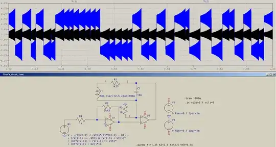

I tried your circuit(s) and I realized you're modeling the PWL source normally, but then you're inverting it with the first opamp. So I added a minus sign to the behavioural source, and tweaked the parameters a bit. Here's what came up:
chua
I simplified a bit the circuit, just for the purpose of making and simulating it, but it's equivalent with your values. The behavioural source also has shrunk a bit, and I made the inflexion points as defined variables, for easier modification. I modified the threshold voltage and the last (highest) inflexion point to be lower. What you see is the result. It does seem to show some randomness. Maybe it's all in the settings.

  • I can't thank you enough for your feedback! I kept my circuit the exact same but flipped the sign on the output of B1 like you did, and it does behave chaotically now. However, I'm confused as to why you inverted the output of B1. Does this have something to do with LTspice conventions for current direction? Also, it takes much more time for the circuit to jump between the two attractors compared to the circuit with the ideal current source. Do you think this because of numerical issues with the simulation or something else? – Vivek Subramanian May 17 '18 at 18:15
    @VivekSubramanian U1 is an inverting opamp, and B1 follows the "normal" approximation, so the output after U1 comes out negative; no current convention, just correcting the sign. As for why the circuit behaves differently, I think it's directly related to the different slopes for the negative resistance you created -- the dynamics chaged, so did the response. – a concerned citizen May 17 '18 at 19:39
  • Thanks for the explanation. I'm sorry, but I still don't completely understand. The output of U1 is negative because it is an inverting op-amp, so if we flip the sign of B1, then won't the negation performed by the op-amp be canceled out by the negation applied to B1? Also, since I kept everything the same but just replaced the ideal current source with the nonlinear resistor I implemented (B1 followed by the two op-amps), why should the dynamics be different? Aren't the slopes of the ideal current source the same as the slopes of my negative resistor? – Vivek Subramanian May 18 '18 at 20:25
  • @VivekSubramanian Think of it like this: The direct behavioural current you modeled was ...direct. Then, you modeled the beh. voltage similar to the current. Then you used that with an inverting opamp, resulting in an inverted slope (i.e. going from bottom left to upper right). If the beh. voltage would have been passed to the circuit, alone, nothing in between, then it would have worked, because it had an expression similar to the beh. current, but like this, it's inverted, so a minus sign is the cure. – a concerned citizen May 19 '18 at 06:47
  • @VivekSubramanian As for the dynamics, your 5th picture shows different slopes, thus the derivatives changed which, most likely, changed the response of the system. – a concerned citizen May 19 '18 at 06:48
