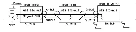

The second kind is temporal functional disruption. There are several possibilities how an ESD event can disrupt the USB data flow. The most serious problem is when the cable shield on hub ports (in both directions) is not connected properly to signal ground plane, if it is simply tied together. In this case the ESD current spike goes along the shield and causes signal ground bounce, either within the hub itself, or within the USB host system. This creates signal collisions that are unexpected by USB protocol, so a hub will intentionally "garble" upstream signals (see Section 11.8.3, Collision), and the host port will be forced into disabled state. This is a mandatory feature of USB 2.0 hubs. Devices don't do this, that's why your FTDI device is less susceptible to ESD when plugged directly into root port. Since the problem is likely in improper shield connection inside your selected hub, no external extra protection will be able so help.
To fix your ESD sensitivity problem you will need to find a "better hub", or modify the current one by de-coupling the shield net from ground net.
AMPLIFICATION: Here is an idea how the shielding should be implemented in a SYSTEM:
There could be some weak coupling introduced between signal GND and SHIELD in host and hub, but all depends of geometry/conductivity of shielded components, and whether FCC EMI is of concern.

  • "The most serious problem is when the cable shield on hub ports (in both directions) is not connected properly to signal ground plane, if it is simply tied together" Ok, so I probed the resistance from the shield to the GND pin, and my meter reported about 0.7 ohms. So that means that they're connected directly, and that's bad, right? – You'reAGitForNotUsingGit Nov 26 '18 at 02:03
  • @AndroidDev, yes, this is bad. – Ale..chenski Nov 26 '18 at 02:04
  • Alright, so, two questions 1) Do you have a link for Section 11.8.3? and 2) Can you point me to a source that details more about how the shield should be connected properly to the signal ground instead of just tied together? (I was talking to someone else and they didn't seem to agree that it was a problem) – You'reAGitForNotUsingGit Nov 29 '18 at 03:24
  • @AndroidDev, Section 11.8.3 is from USB 2.0 base specifications, found in any USB.org document source, inside a big ZIP file. https://usb.org/document-library/usb-20-specification-released-april-27-2000 Regarding shielding, "Ask six electrical engineers how to correctly ground and shield a measurement system, and you’ll likely get 12 different answers." https://www.edn.com/electronics-news/4381145/Grounding-and-shielding-No-size-fits-all – Ale..chenski Nov 29 '18 at 04:10
  • @AndroidDev, see also some major background here (ESD and EMI are parts of the same problem), https://www.emiguru.com/ , and this article in particular http://7ms.com/enr/online/2010/02/notebook.shtml – Ale..chenski Nov 29 '18 at 05:13
  • @AndroidDev: For what it's worth: Having my curiosity awakened, I just measured the shield-ground resistance on ten "consumer level" usb-hubs in the 5-30 euro price range, from different manufacturers, including icy-box, anker, sitecom, speedlink. None of them had any appreciable resistance from shield to ground (all <0.5 Ohms). Most had upstream-shield, downstream-shield, and board-ground connected, but some had either upstream-shield or downstream-shield unconnected. – djvg Apr 19 '19 at 10:22
