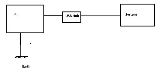

Noise originating from the PC and through USB Hub goes into the System. This happens when a nearby device next to PC is activated like motor. All I want to suppress and try if I can attenuate the noise coming through earth or mains through USB cable first.

  • @Andyaka It is used from a PC USB port to a USB Hub's port – GNZ Dec 12 '18 at 11:10
  • Show how you would intend to use it. – Andy aka Dec 12 '18 at 11:11
  • @Andyaka See my edit. System is isolated and only have contact to USB Hub. – GNZ Dec 12 '18 at 11:19
  • It's likely that if the noise is coming from a motor (as you say) then adding the ferrite won't really achieve anything. Have you tried it and noticed any improvement? – Andy aka Dec 12 '18 at 11:20
  • @Andyaka No I didnt try it. It happens only when it is switched like a pulse EMI Not continuous I mean opponents during switch on'. – GNZ Dec 12 '18 at 11:21

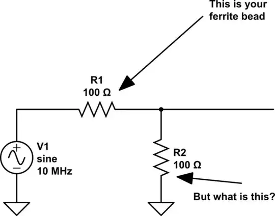

All filters are voltage dividers, like this
schematic

  • In summary, I think you can say this: until current flows through a ferrite bead, you can't know its attenuation. If R2 is infinite, R1 doesn't attenuate. – glen_geek Dec 12 '18 at 16:45
  • But dont you guys have any idea what can R2 be roughly if it is a USB port? – GNZ Dec 12 '18 at 16:51
  • @analogsytemsrf I like this kind of circuit involved precise explanations thanx – GNZ Dec 12 '18 at 16:52
  • What will R2 be (what is the impedance) if that impedance is the input to a USB hub? Suppose you want 12,000,000 bit rate? You'll need about 20 nanosecond time constant. Suppose you need 100 ohms to terminate the USB line. The USB line needs to look resistive up to about 100MHz to minimize reflections. Thus you can insert 100 ohms into R2. What if your USB is much faster? Then the USB line still needs to look resistive, but to much faster data rates. – analogsystemsrf Dec 13 '18 at 14:19
