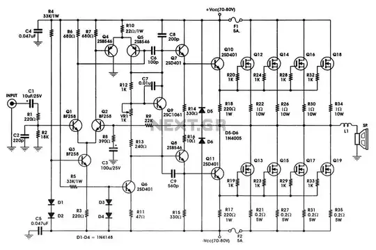

  • @Damien: I am not too familiar with SMD components. I have large heatsinks (30cm20cm5cm fins) with threaded holes on which I could easily mount TO220 Fets. Would you have a recommendation for MOSFETs similar to BUK7Y102-100B in TO220 ? Maybe BUK7575-100A ? There is a DC line in the SOA with 10A at 10V. I could try to put 8 in parallel to be safe. – Akira Doe Oct 25 '18 at 20:30
  • @AkiraDoe from the graph of this Mos, you can probably have 5-6A at 12V in DC so I would put at least 10 of them. – Damien Oct 26 '18 at 02:51
Use one opamp that is able to drive a fairly high current (20+mA) and add a 1k resistor at each gate of the mosfet.
A good example is an audio amplifier, you don't need to care about the regulation circuit as you are using a op-amp but it shows the Mosfet being paralleled.
As the mosfet has a positive temperature dependence in relation to the temperature, they will automatically compensate in current flow and avoid thermal runaway.

  • I think an important part of the above circuit which hasn't been noted (and I think contributes to it working), is that each MOSFET has its own source resistor (the 1R- R18,R22,R26,R30 etc), which helps the MOSFETs to share the load current. – user85471 Oct 25 '18 at 22:36
  • @user85471, the resistor a part of the mosfet balancing between high side and low side to have 0-crossing, it it not needed in the OP application. – Damien Oct 26 '18 at 02:48
