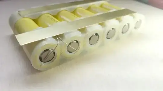

I am building a battery with 18650 cells. These cells will be individually fused using a cell level fusing method like this:
cell fuse (Image source)
The idea is to connect the battery to the main bus with a wire that can carry the current under normal load. In case of a short of the cell, the other cells in parallel will discharge into the short and blow the fuse. The faulty cell will be isolated.

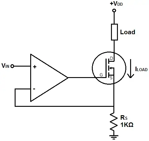

[UPDATE:] On another forum (not dedicated to electronics), I got this schematics. Does it makes sense to you? I'd change the resistor for 5 mohms (200 mV range for 40 A and 10 W in the resistor). The power side would be a car battery.
Here is the link : https://endless-sphere.com/forums/viewtopic.php?f=14&t=96779#p1417904
ajustable current source
Could you give me your opinion as electronic experts? Side question: Do I need a gate resistor to feed the FET or do I connect it directly to the Amp pin?
@andy aka published a comment asking details on how I plan to overcome thermal runaway of the FET. I have no idea, my knowledge in electronic is low. I planned to use a FET rated for high current (IRF1404Z with Rdson of 3.5 mohms) and use a huge heatsink. If there is a way to use several FETs in parallel to lower the charge on each, I would be glad to read about it!

The circuit shown is indeed a plausible place to start. However, I built one about 10 years ago when testing military robot batteries. They only needed 10A discharge rates, and I was using 6 big MOSFETs in parallel. Each FET needed an equalization resistor in it's source leg before they all connected to the current sense resistor. this is because the gate threshold voltage is slightly different for each MOSFET and so, as I saw on my thermal camera in real time... the one with the lowest threshold turns on first and starts to heat up. Gate threshold voltage drops as temp increases on a MOSFET so, the first one overheats, ops, and the second lowest turn on threshold part starts to fry itself. :-) So, You need to make sure your series resistor is large enough to get everyone turning on no matter how much shift there is in the gate threshold. It also helps if you look for FETs that are designed for use in the linear region. [though they are more expensive and harder to find.] Also, use a separate op amp for each FET with some series resistance driving in to the gate to avoid too much capacitive loading on your op-amps. Good luck. on another note, have you considered just using a current limiting power supply?

So what you need is a "DC electronic load".
You can do it yourself, your principle schematics seems good, (example) but it will probably be a hard project.
Or you can buy a laboratory DC Electronic load. Some electronic loads have related batteries features (capacity measure, ...). It exists Power Supply + Electronics loads in the same device in order to automatically charge/discharge batteries.
