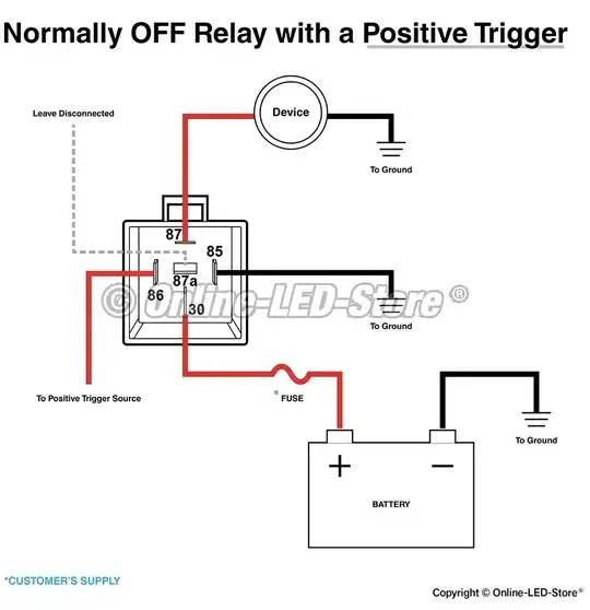

Here is the diagram for the normally off circuit they have:
Normally off circuit

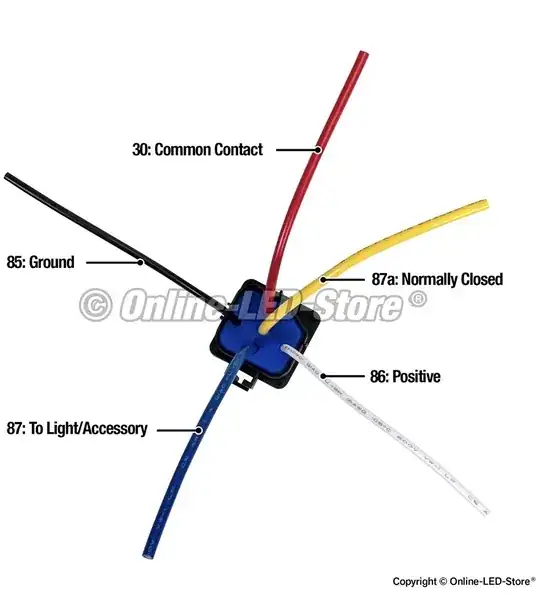

Here is the wiring harness:
Wiring harness

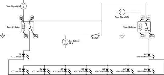

And here is the diagram I came up with to accomplish my task. As I stated before, I’m not great with technical terms so please pardon that.
schematic

Also, if the above isn’t possible, even the normally off diagram didn’t work; how can I correct to achieve it?

  • Made a schematic with what I explained, but no, that won't work as I thought. The lights would still alternate. With regular switches or relays, it would be easier to tap into it, as you could use the control switch as well. Hmm, I'll keep thinking. That, or use timer relays or micro controllers. – Passerby Oct 20 '18 at 18:45
  • @Passerby Will what I have blink when the switch is off, and stay on when the switch is on? I appreciate the help, and at least a basic setup will hold me off to buy addition components later if needed. My budget is roughly $50 for the next purchase so if you’ve got a way to accomplish the full goal with what I have plus less than $50 worth of extra components, then feel free to post it! :) – Hazel へいぜる Oct 20 '18 at 18:51
  • You have it wired so the running board is off when the turn signal is off. They blink together, but the running board is off most of the time. If you connect the running board positive to 87a instead, the running board is on when the turn signal is off. So they will blink in alternate manner, with the running board on most of the time. The other connections, 30, 86 and 85 are good. – Passerby Oct 20 '18 at 18:56

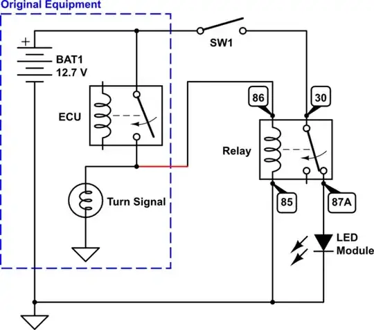

This is a simple schematic, for alternative blinking. Turn bulb on, your led module off. Once the turn signal stops blinking, the running board would stay on, as long as your Switch is on. Side note, I hope you added a fuse to your wiring between the battery and switch. Safety first.
schematic

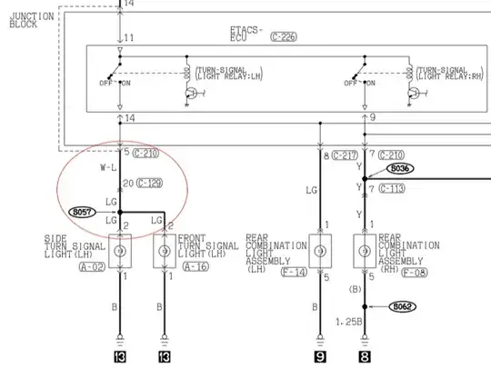

The turn signal power must come from before the turn bulb, somewhere from the red circle, or a similar connection. (Wiring diagram for some unknown year of Mitsubishi Lancer, see page 9-70) Just tap/slice into it.

  • I’m not fully educated in reading the first schematic; can you explain 87a and 85 both connecting to the led? – Hazel へいぜる Oct 20 '18 at 19:30
  • Okay, so connecting 85 to ground and negative to the negative on the battery got it to work; I’m assuming the relay is supposed to click audibly? – Hazel へいぜる Oct 20 '18 at 19:35
  • Yes. 85 is the negative side of the relay coil, so it should, in this use, connect to ground just like the led module negative connects to ground/battery negative. 87A is the "Normally connected/closed" side of the relay's switch. When the relay is off, it physically connects 30 to 87A, providing a route for power to your led module positive. And yes, the relay will audibly click. That's normal for mechanical relays. – Passerby Oct 20 '18 at 19:37
  • one last question on this; if my switch is in the off position the led shouldn’t blink correct? – Hazel へいぜる Oct 20 '18 at 21:21
  • If your switch is in the off position, it shouldn't be on at all. That's the switch in your diagram. If you want a switch to just turn on and off the blink feature, add it either before 86 or after 85. – Passerby Oct 20 '18 at 23:00
