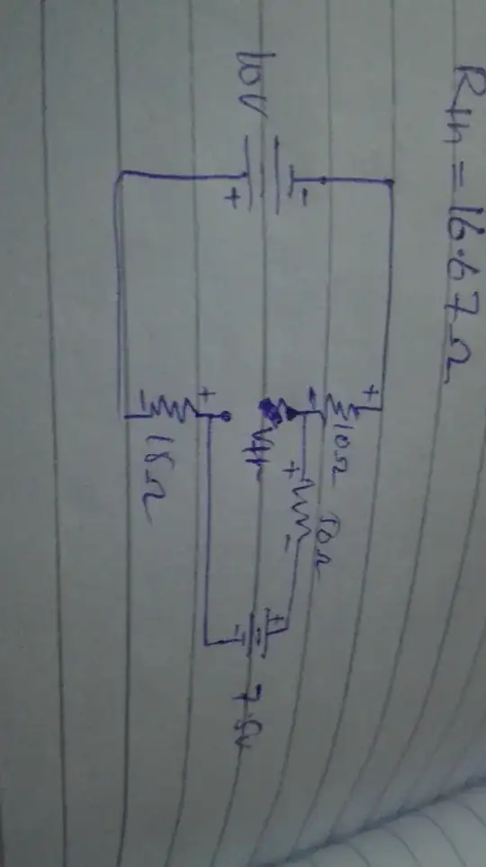

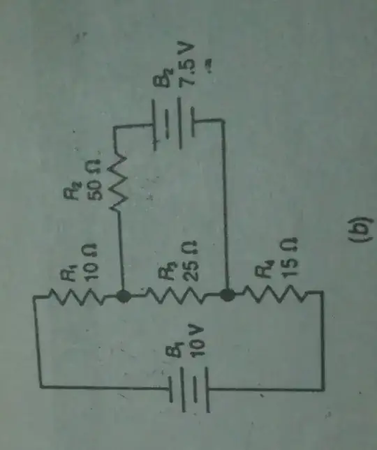

i have been asked to solve a circuit using thevenin theorem but when i try to solve it to find Vth by loop analysis, i realized that both voltages are in opposing directions and i can't understand that how can i write the loop equation for it. enter image description here [1]: https://i.stack.imgur.com/OK0QK.jpgenter image description here This is where I'm stuck. I want to find Vth.

  • Use KVL - there is only one mesh once you’ve removed R3. – Chu Sep 30 '18 at 00:39
You must apply the Superposition Principle.
It is about passivating one of the power sources and solving the unknown with the other power source. Next, the other source is passivated and again the unknown is solved with the source that was passivated in the first place.
In the case of voltage sources, passivation implies that the source is removed from the circuit and instead, an impedance equal to the internal impedance of the source is placed. If the circuit model is ideal, this corresponds to removing the voltage source and instead placing a short circuit.
If it is a question of current sources, we proceed in the same way, removing the source of the circuit and placing in its place an impedance equal to the internal impedance value of the source. If the model is ideal, the current source is removed and an open circuit is defined instead.

Your solution is wrong on Thevenin equivalent. In first you have to cut circuit on R1 and R4 nodes then work on remaining part. Thevenin euivalent is composed by a voltage source and a series resistor that is the one when you short voltage source and open current source. When applyed to, R2 result in parallel to R3. As I read RTh is 16.67 or 2*25/3 not 10 (50?) Ohm as seen on your hand writing. Equivalent Thevenin Voltage source is the voltage at node of cut circuit so it is voltage across R3 (on cut part) By voltage divider VTh = VR3= B2xR3/(R2+R3) 7.5x25/75 so it is 2.5V. Reconnect Thevenin Equivalent to R1 R4 then evaluate current loop: is the remaining voltage loop divided by resistance of loop: (B1+BTh)/(RTh+R1+R4)

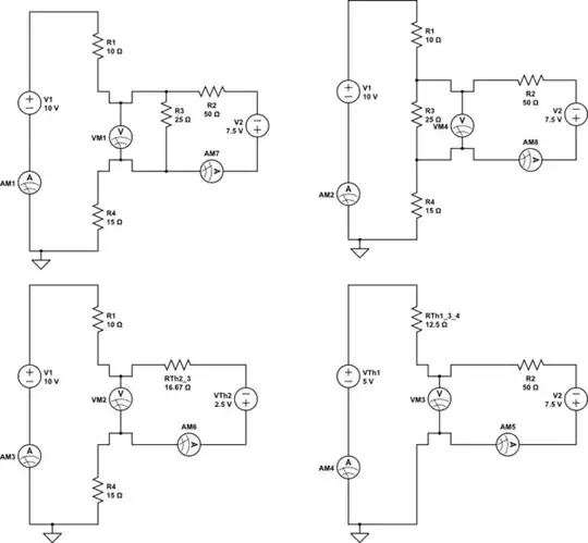

I seen Martin answer checked as best answer but I cannot see Thevenin applied to. As from these two schematics, one can solve by cutting circuit from left or right of R3. Upper are original circuit with a rotated C where to cut. On bottom are Thevenin equivalent of original
On left Generator V1 remain untouched with R1 R4, Gen V2 and R2 R3 whre changed using Thevenin
On Rignt V2 remain untouched with R2 R3, Thevenin apply to R1 R2 R3
All voltmeter display 2.5V positive upper. Applying superposition, V1 on V2 Off voltage across R2_3 result in 4V V1 OFF V2 On Voltage across R1_3_4 result in -1.5V So voltage across the two nodes again result to be V11+V22 = 4+(-1.5) again 2.5V
