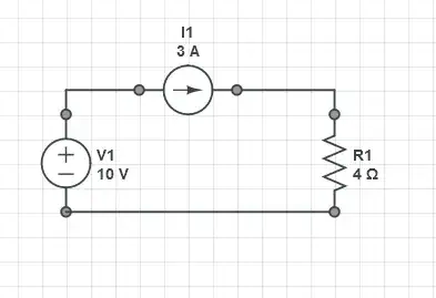

For example, the circuit has a current source and a voltage source connected in a series with a single resistor which
  • The voltage source supply 10V
  • The current source supply 3A
  • The resistance of the resistor is 4 ohm. enter image description here
How can Ohm's law be applied in this case.
If we take 10V then the current will be 2.5A which is lack of 0.5 A to make the sum of current equal 3 as the current source supply while if we take the current through it is 3 A then the voltage through it wil be 12 V that over the one which voltage source can supply. I have seen many circuit which have both of these source without knowing how to apply Ohm's law on it.

I understand the circuit you propose is like Fig.
schematic
It can be solved by applying the principle of superposition.
First, solve for the voltage source, current source passivated. In this particular case, passivating the current source, the voltage applied to the load is zero, and that is in open circuit.
Secondly, solving for the current source should passivate the voltage source (replace it for a short-circuit). This allows us to calculate the voltage across the resistor as:
$$ V_R = I\cdot R = 3\cdot 4 = 12\mathrm{V} $$
This is consistent with the physical characteristics of a voltage source (low output impedance) and a current source (high output impedance). In practice, the voltage source should be capable of supporting the current set by the current source.

  • it look more like this http://i.imgur.com/F6FwwQF.png . Still, I don't understand why in 1st case it is open circuit – aukxn Sep 16 '14 at 15:15
  • @aukxn I do not see the difference between the schemes ... However, passivation is the current source for the first case. Passivating a current source corresponds to replace it with an open circuit. Analyzing the circuit in this condition, there is no voltage present on the resistor. – Martin Petrei Sep 16 '14 at 15:26
  • Sorry, I'm not native english speaker, the word "passivation" is too hard for me to understand. Can you explain it in other word? – aukxn Sep 16 '14 at 15:27
  • @aukxn "Passivation" means nullify the effects of that source. This is necessary to apply the principle of superposition, where it is analyzed separately the effect of each source in the circuit. – Martin Petrei Sep 16 '14 at 15:31

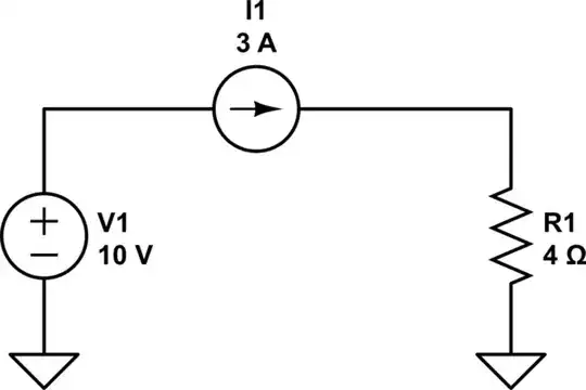

Speaking with respect to ideal components:
Voltages sources supply whatever current is necessary to get the desired voltage. The current can be positive, zero, and even negative.
Similarly, current sources supply whatever voltage is necessary to get the desired current. So there is a voltage across the current source.

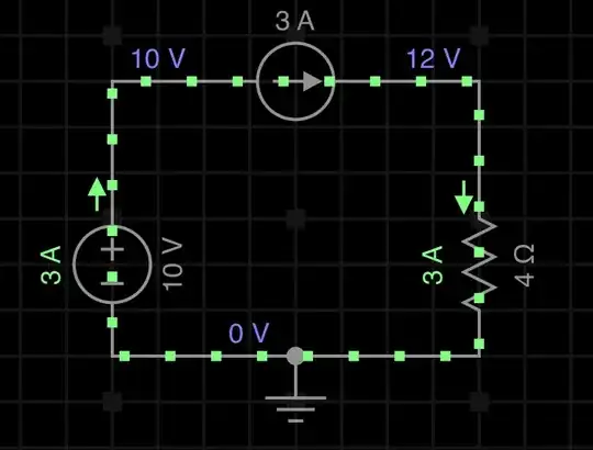

So, we know due to Ohms Law that 3A through a 4 Ohm resistor produces 12V across the resistor. We know the voltage across the voltage source and the current through it as well (3A). Therefore there must be 2V across the current source. I did a simple simulation to show this. Simulation from EveryCircuit
