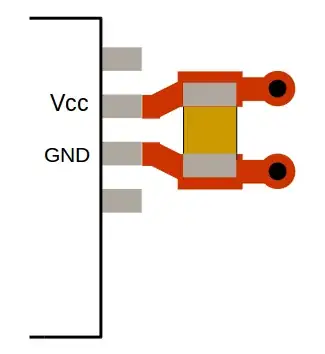

Are there common guidelines for bulk capacitors? If I have the decoupling capacitor placement shown below (where the vias connect to Vcc and GND planes):
And I need to place a bulk capacitor in parallel, which option is recommended?
  • Option A: Bulk capacitor connected before the vias (i.e., move the vias to the right and place the bulk capacitor between the decoupling cap and the vias)
  • Option B: Bulk capacitor on the right of the vias, and the traces from the IC pins touch the decoupling capacitor pads, then touch the vias, then continue to the bulk capacitor?
What if the bulk capacitor did not fit nearby and is (relatively) far away from the decoupling capacitor?
Does the situation change if:
  • The bulk capacitor is shared for two or more Vcc pins? (each of those Vcc pins would presumably have its decoupling capacitor connected like in the figure above)
  • Several pins of the IC connect to the same supply, but each of the pins is supposed to be decoupled by a pair 0.1uF ceramic + 10uF tantalum?

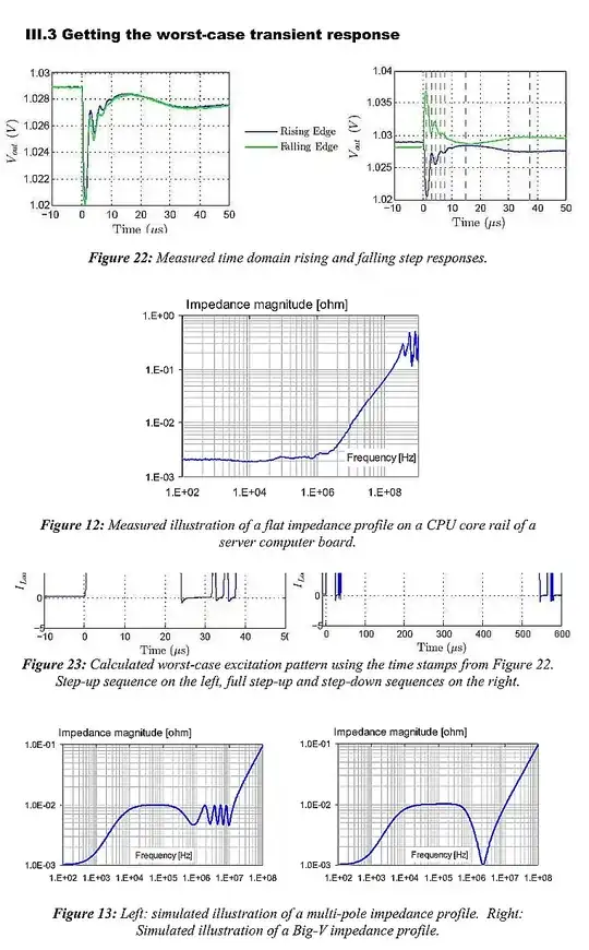

Retooling our experience for modern PS noise budgets and high dynamic pulsed loads requires learning about;
  • how to set noise budget
  • what frequencies to measure a power design network's (PDN) self and transfer impedance
  • how to read an impedance plot to optimize performance
  • how to test Z(f), stability , PSSR, step load, ripple and load regulation error
  • what test equip. is necessary to be successful
For more details on RLC impedance plots on Caps, effects of bias voltages and types examples below enter image description here
