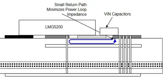

The inductance of the decoupling current is usually given by its loop, set up by the delimiting planes/vias/capacitor leads. The following scheme is usually shown to understand the inductance of a decoupling capacitor (image from p.17 here):

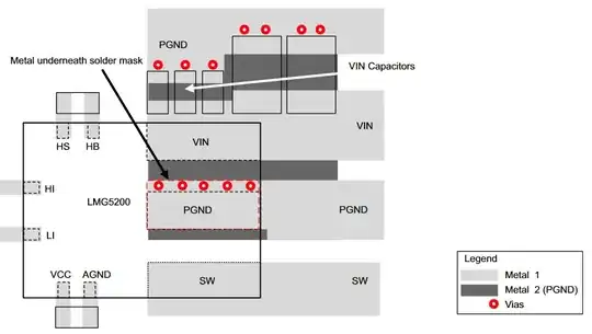

So far so good. Now the same document also shows a suggested lateral placement of several capacitors on p.16:
This document is of course not alone with these suggestions. It is a general practice that I have seen many times. Maybe what makes this reference slightly more relevant is that it doesn't focus so much on ripple current capacity, but really on the loop inductance of the input capacitance.

If several (\$N\$) capacitors are paralleled, then - regardless of how many - the first image above always holds, i.e. the entire decoupling current still has to travel around the entire blue loop. The document is right to note that the current in Layer 1 and Layer 2 is opposite creating low inductance (aka: a small loop area), but the current through all the capacitors is still in parallel, so there is no flux cancellation from paralleling those capacitors and hence no inductance reduction. Correct?

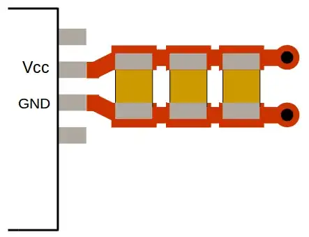

I think the problem is the first drawing is only 2D so when looking at the cross section of the PCB, you only see the cross-section of the loop. However it also has another dimension, which would be its width when seen from the top in the second drawing.
Wider conductors have much lower inductance than thinner ones. A loop made of wide conductors stacked on top of each other (ie, copper pour over plane or wide trace over plane) will have inductance roughly inverse proportional to width. Caps are part of that loop too, and too few caps create a bottleneck reducing width.
So by putting several caps in parallel you don't change the cross section of the loop, but you increase the width of that loop. Thus inductance is reduced.

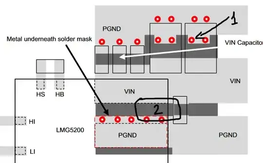

If the two caps on the right are big enough you can put vias under them (#1 on drawing below) to reduce their inductance. If you think about the cross section you'll see that removes a little bit of the thickness of L1-L2 prepreg.
#2 shows the loop if the caps are placed in the "logical" "intuitive" place, this would probably turn out with more surface area and worse inductance than the suggested placement.
I've seen appnotes where half the caps are flipped to cancel the magnetic field. This seems to work but it makes a lot of holes in your top copper pour for ground vias, which makes it narrower, so higher inductance: in this case it would probably not work well. It was suggested for plane to plane decoupling, in this case the cap has 4 vias anyway.

Yes. Roughly speaking, inductance is proportional to [trace] length and [substrate] height, and inversely proportional to [trace] width, of the loop. Using multiple capacitors in parallel, broadside as in the placement shown, reduces component ESL approximately in proportion to count.
In contrast, placing them like a ladder, with the load at one end, does not:
Parallel capacitors in a ladder, modified from https://electronics.stackexchange.com/questions/397647/bulk-capacitor-placement-routing
This way, the ESL from each capacitor, and the traces between them, form a ladder network. The ESL of the others act in parallel with the first, plus strays; the result is less ESL than a single part, but more than with them broadside.
