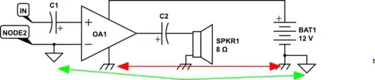

I am currently looking at this schematic and I'm clueless about the part on pin 5 where the ground on the capacitor should be connected into something that is labeled "To Large Signal GND". What does it mean? (Chip: LA4597)
Ground
  • 131
11
That chip is an 11 W audio amplifier. It takes low-level signals (< 1 V) and amplifies them in voltage and current. The output current at peak volume will be several amps. Several amps flowing through the PCB traces will cause a slight rise in voltage along the trace and if this alters the ground voltage at the inputs distortion and instability may result.
Note that the capacitor is on the amplifier power circuit. I imagine that this cautionary note is to minimise the risk of an audible "thump" when the amplifier is switched in and out of standby.
schematic
Figure 1. A very crude representation of an audio amplifier using two different ground symbols for the small-signal and large signal grounds. Both are connected at only one point - often referred to as the "star" point and usually located close to the power supply. The red arrows signify the large current paths and the green the small-signal paths.
The solution is to separate the small-signal and large-signal grounds. For you this means that all the left side capacitors will be connected to the small-signal ground.

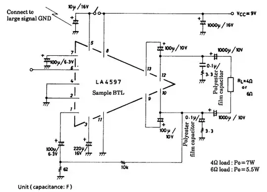

I had a look but, unfortunately, can't find a recommended PCB layout.
From the comments:
But what about the amplifier grounds (4 & 11) and the ones going out of a resistor (10 & 12)? Where should I ground them?
Figure 2. Schematic from the datasheet.
I would take this diagram in conjunction with the one you posted to show that all the small-signals are on the left.
  • 4 is part of the inputs so keep that with the signal grounds.
  • 11 looks like the main amplifier ground so high currents can be expected there.
  • The resistors out of 10 and 12 in your diagram are the speakers and they will be high current.
Note that my Figure 2 shows the amplifier used in bridged mode where two amplifiers running in anti-phase are driving opposite ends of the speaker. This allows double the voltage swing on the speaker compared with the arrangement shown in your schematic.
