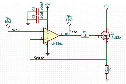

I've been trying to make a current source, and have finally gotten my hands on some LM8261's which should be an 'unlimited cap drive' op-amp. The problem is, it is still oscillating.

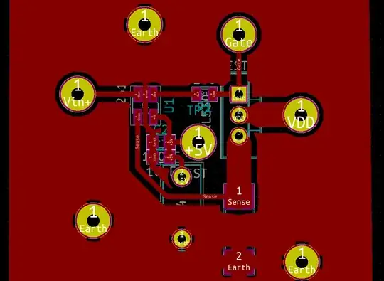

This is the schematic and PCB layout:
schematic
pcb layout
I have tried to route the ground inside the loop area, close to the 5V connection for the opamp, so I could place the bypass capacitors as close as possible. Although the bigger 10uF cap has one of its legs at the groundplane (forgot to include this cap in the schematic picture.)

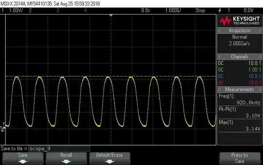

This is what it looks like when I probe the gate of the MOSFET:
scope1
It's all over the place.

I've tried with and without the gate resistor R1, it didn't seem to make any difference.
What is going on? Any clues on why this just doesn't work?

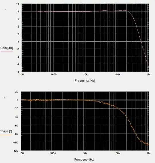

The gain/phase bode plots I made on the PCB:
G/P plot
Bandwidth of approximately 350kHz! Very pleased.

    Try this https://i.stack.imgur.com/wxc0K.png – G36 Aug 25 '18 at 16:03
  • @G36: Yes reducing the bandwidth like that could maybe do the trick, but that was the point of using the the LM8261, this shouldn't be necessary. I dont want to stablize it to death, i want to have some kind of bandwidth, like a 100kHz or 200kHz loop bandwidth maybe :) – Linkyyy Aug 25 '18 at 16:07
  • @Linkyyy G36 is correct, though. You pretty much need to do that, or something similar. (I think Andy's and Mat's answers completely missed this problem, the one that G36 readily caught for you.) – jonk Aug 25 '18 at 17:05
  • @jonk: But why? The op-amp should be able to handle this load, shouldn't it? – Linkyyy Aug 25 '18 at 17:18
  • @Linkyyy Do a Bode plot. It should become pretty obvious when you look at it without the capacitor in place. – jonk Aug 25 '18 at 17:20
I've been trying to create a current source, and have finally gotten my hands on some LM8261's which should be an 'unlimited cap drive' op-amp.
Finding a chip that can drive a capacitive load is one thing but then using a 1 kohm in series with the output to drive that capacitive load is asking for trouble.

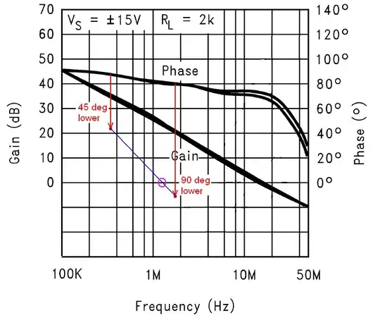

Reason: the 1 kohm and the MOSFET gate-source capacitance form a low pass filter within the feedback loop and push the phase margin of the op-amp to 0 degrees at a moderate to high frequency turning the circuit into an oscillator.
Look at the phase margin in the data sheet and note that if you factor in the 1 kohm resistor and about two-thirds of the gate source capacitance, the phase margin graph turns into the blue line I drew below: -
And, the phase margin crosses zero degrees (i.e. it becomes an oscillator) at about 1 or 2 MHz (magenta circle). How did I do this you may ask?
Well even though there is a resistor in the MOSFET's source it doesn't do very much for reducing the gate capacitance - it might reduce it to about two-thirds so, 900 pF GS capacitance and a 1 kohm resistor form a low pass filter with a 3 dB point at 265 kHz. At that frequency the extra phase introduced is 45 degrees hence I drew a red dot 45 degrees lower.
Then I considered a frequency that is five or ten times higher just so I could roughly pin-point where the added phase shift limits at about 90 degrees and drew the 2nd red dot.
Then I joined up the two dots in blue and drew a magenta circle where phase margin is modified to 0 degrees (the point of closed loop oscillation where negative feedback becomes exactly positive feedback.
It's not a massively accurate technique but can tell you whether you are going to hit trouble.

  • I didn't have any gate resistor in the first place actually, and it was still oscillating. I tried a few values, 100ohm, 1k, to see if it would make a difference, but it didn't – Linkyyy Aug 25 '18 at 17:17
  • @Linkyyy the op-amp itself has internal resistance in its output that will do the "bad-job" just as effectively except that the oscillation frequency will likely be higher because the resistance is smaller. – Andy aka Aug 25 '18 at 17:43
  • That makes a lot more sense actually. the output resistance of the op-amp might be pretty significant because the mosfet is inside the feedback loop. What kind of bandwidth do you think is achieveable in a op-amp/mosfet configuration? i was hoping for something like 100kHz or more, but it seems like that is kinda impossible with a mosfet with this amount of input capacitance.. – Linkyyy Aug 25 '18 at 18:27
  • A lot of folk use BJTs for this reason but if you need the output drive currents from a MOSFET then you could experiment with a BJT emitter follower driving the MOSFET - this will mean that the 1 kohm resistor can be ditched because now the op-amp is driving a higher impedance due to the insertion of the BJT. The BJT emitter will probably need 330 ohms to 0 volts to achieve high frequency performance and connect this to the MOSFET gate.... – Andy aka Aug 25 '18 at 18:37
  • ... If all you succeed in doing is pushing the oscillation frequency up several MHz then that is a start because then you might be able to drop 33 pF (or thereabouts) between op-amp output and inverting input to remove a little HF gain and you might get lucky. I would heartily recommend simulation first - try and get it to "sing" at about 1 MHz and then try the BJT buffer. MOSFET based constant current circuits operating at more than a few tens of kHz are tricky. – Andy aka Aug 25 '18 at 18:37
  • Thanks a lot. I did some open and closed loop simulations with the BJT common collector configuration, and it looks good. https://imgur.com/a/tBprTjh. When i close it, and make an AC plot from input to the gate of the MOSFET, it is very flat, and with a bandwidth of around ~180kHz. – Linkyyy Aug 26 '18 at 12:29
  • I tried butching in the parts on the PCB in the lab, and it looks like the oscillations is gone now! I tried doing a frequency sweep with the scope and i noticed that at around 25-30kHz, there was noticeable more gain, than at lower frequencies, and then it dropped off. Like there is a frequency peak in the closed look response around 25-30kHz. Im not sure how or why though. Do you have any clues? – Linkyyy Aug 26 '18 at 12:29
  • @Linkyyy it's good you got rid of the oscillations. Can you post the revised circuit and possibly the closed loop frequency response? How much is the hump in the middle frequencies in dB terms? The open loop response looks excellent BTW. I'm very pleased with that. Add the pictures as an "edit section" to the bottom of your original question for greatest clarity for people stumbling on this question because it might be useful to other folk wanting a wide band current source/sink. – Andy aka Aug 26 '18 at 14:03
  • I updated the album with the closed loop simulation: https://imgur.com/a/tBprTjh. I didnt have any BNC equipment available so i could not use a gain/phase analyzer. I used the scope's signal generator and manually swept the frequency. I will see if i can borrow some equipment next week to make the right measurements, but basically i believe i saw something like this: https://i.imgur.com/fDP0CZ4.png with the peak being at around 25-30kHz and the magnitude 3-6dB(around double the voltage). so nothing like the simulation – Linkyyy Aug 26 '18 at 16:18
  • It might be the 1nF local feedback capacitor - presumably you felt this was needed and I'm wondering if it can be lowered and see if the hump moves. It could be a layout thing although your layout does look OK. This is new territory for me and I know they can be hard to get working decently at this sort of bandwidth. Did you try increasing the emitter resistor towards the 330 ohm value I mentioned. As you can tell I'm scratching my head a bit! – Andy aka Aug 26 '18 at 16:34
  • Good news! i borrowed some BNC cables and soldered that to the PCB to make some better gain/phase plots, and it is way better now! I updated the first post with the results, and i will mark your post as the solution. Thanks for your help! – Linkyyy Aug 28 '18 at 14:02
  • Those results look good. One note - some folk might want to see the final circuit (including me!). Maybe you can add it to the post for posterity in case imgur screws up. This has been a useful exercise. – Andy aka Aug 28 '18 at 14:32
  • I will do that! – Linkyyy Aug 28 '18 at 14:48
