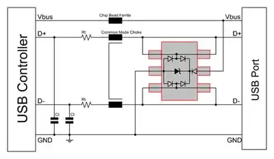

  • Andy aka: I can show you this much:
All I can show of the actual PCB is this:
You can see that the ground plance stops short of the USB socket. The large hole is where the tabs for the USB shield to have a mechanical connection to the PCB. R1 is then connecting the shield to GND, and capacitor C3 is doing the same on the other connection. The shield is connected to ground via the 100k res/100nF cap. There is a metal tab fitted to the PCB which rests on the metal chassis. According to the old ESD report, this was needed or the device failed. As far as I can see, these were the only things added in addition to that example circuit to protect from ESD.

  • Take that picture and add details that show what extra you have done to connect the shield to the metal box (via a cap and resistor?). At the moment, the picture gives no clue to me what is the device that fails and what other precautions have been made i.e. it is too generic to be useful. – Andy aka Aug 08 '18 at 11:07
  • @Andyaka I have added what I could. I did say things I have tried myself earlier in the question. Let me know if any more information will help and I will provide what I can – MCG Aug 08 '18 at 11:19

  • I'm struggling to understand where your box is relative to the original diagram. Is it the left side or the right side. That is why I suggested you modified the original picture. – Andy aka Aug 08 '18 at 11:52
  • The box (Stainless Steel housing) does not make direct contact. It is a round tube so technically, it is all around it. The PCB slides in and it has a metal tab that connects the PCB ground to the housing. That is it. The resistor/capacitor just connects the shield to GND. The tab is located approx 12mm away from the USB connector. – MCG Aug 08 '18 at 11:59

By the description and the basic schematics provided. It looks like they are using the wrong TVS circuit. Because the +/- data is balance transmission line, and the TVS circuit in the schematic is for unbalanced transmission lines. Shield is little of importance compared to this circuit and how well it operates to protect, and only really needs to be grounded at one end for its basic function of the circuit. Here is a good application guide from ON semiconductor for future reference. https://www.onsemi.com/pub/Collateral/AND8231-D.PDF

  • As I mentioned in the comments, I noted the design was based on that circuit. It was just one I came across that circuit online that used TVS diodes so used it as an example. And for ESD, the shield seemed very important. The bigger problem was space constraints leading to lack of ground plane I believe. It was a while ago since I worked on this circuit as we have now released an updated version based on my findings which has eliminated this ESD issue. However, thank you for your input and the application note is indeed useful. – MCG Apr 23 '21 at 07:02

I have two solutions:
Solution A
Replace C3 with the largest capacitor possible (micro, not nano farads).
If this does not work, then
Solution B
1) Remove the resistor and capacitor that were added (R1 & C3),
2) disconnect ground from this connector,
3) solder a wire from the shield tab (R1 C3 node) to this connector ground and the other end solder it to the PCB ground tab of the opposite connector.
The net result of these instructions, is to isolate the PCB ground plane from the USB shield. This way, when the USB shield is zapped, the ESD will bypass the PSB and go to ground.

  • Unfortunately, this isn't really a correct answer. If you had read through my question fully, you will have seen that all your solutions are ones that I have tried and that I had solved the ESD issue. My question was whether it was ok to do it like that, based on the articles I had read about it. – MCG Aug 09 '18 at 20:44

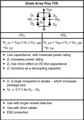

If I look at your circuit correctly and also look at the https://www.onsemi.com/pub/Collateral/AND8231-D.PDF I see that you have used a device (Diode Array Plus TVS) used for Use with single−ended data line and the USB protocol is supposed to be a differential protocol.
The link informs that you should use Schottky Diode Array or Diode Array instead, which are meant for Differential data lines.

  • I won't downvote as it is useful info, but it doesn't really answer the question that was asked/ And if you had read it fully, it was a circuit designed by someone else from years ago and I was unable to make any actual circuit changes. – MCG Nov 18 '21 at 15:25
  • While USB signalling is indeed differential, the data lines themselves are always positive relative to the ground, so they require unidirectional TVS protection. I highly recommend reading AND8424-D application note by ON Semiconductor to avoid the confusion. – Maple Apr 07 '22 at 14:06
