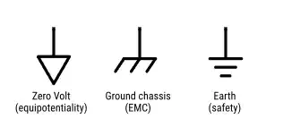

I don't think there's a lot of conflicting information, but rather a lot of information that depends on context or EMC notions.
To understand, it's important not to confuse these symbols. Zero volt (equipotentiality), ground chassis (EMC) and earth (safety).

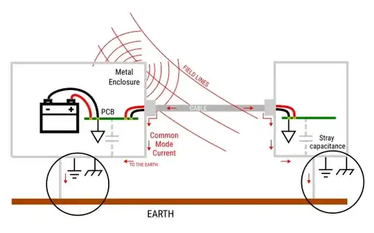

The general vision is as follows :

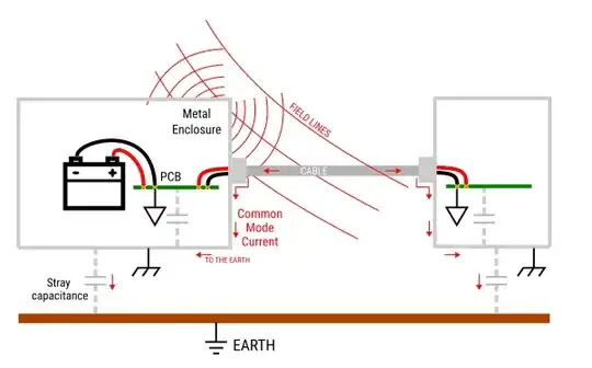

In theory, shielding can be floating. If it is hermetically sealed, the Faraday cage effect is obtained and the common-mode currents are drained off by parasitic capacitances.

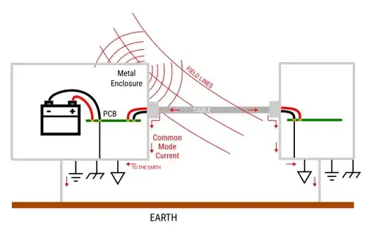

Sometimes for safety reasons (class I devices requirements, reducing the accumulation of static electricity, ...) the enclosure must be earthed, and the parasitic capacitance (enclosure/earth) disappears, improving the efficiency of common-mode current evacuation.
In your electronic design, you always have to deal with the problem of internal EMC, and the parasitic capacitance between the printed circuit board and the metal enclosure is not ideal. A solution consist to connect directly the zero volt to the ground enclosure.
That's a general view of the problem ! There's a lot to be said for compromises in context. For example, if the two devices are in different buildings and with different earths, this configuration poses a problem because the 0V would be different. There's also a lot to say about one-point grounding or multipoint grounding inside the enclosure versus distributed stray capacitances in HF. The ground loop influence, etc...
