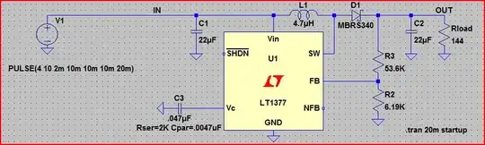

A constant power load varies it's impedance on change of input voltage to keep the power constant. A constant impedance load is simply a load that presents an unchanging impedance, like a resistor. An L-Pad is used to change speaker output level whilst maintaining a constant impedance load to the amplifier.
A good example of a constant power load is a switching regulator. Since this has to maintain it's power into it's load, it must draw the same power from it's source even if the source changes voltage.
This is also an example of a negative impedance because in order to maintain the output power, if the voltage in drops, the current must rise (opposite to a standard resistor where the current and voltage rise/fall with each other)
Here is an example circuit, made from a LT1377 boost switching regulator:
Constant Power Load

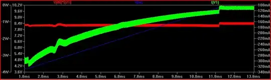

Here is the simulation:
Constant Power Simulation
The input voltage V(in) (blue trace) starts off at 4V, and gradually rises up to 10V. We can see the power (red trace) stays constant at ~1W over a change of 6V at the input (it's not perfect as it's meant to represent "real life" and not 100% efficient, but it's pretty close)
We can also see the dynamic negative resistance characteristic (green trace) which is due to the input current falling as the voltage rises. Tt falls from ~300mA to ~120mA over the voltage rise from 4V to 10V - don't be confused by the minus sign, that's just the direction of measurement in LTSpice.
The dynamic resistance slope can be roughly calculated by (4V - 10V) / (300mA - 120mA) = -33.3Ω. Looking it another way, 6V / -33.3Ω = -180mA.

  • Thank you very much for that answer, it was really ilustrative. However I have just a question, when we are talking negative impedances, I can understand the fact that it raises the current when the voltage lowers, but how is this exactly, does it actually mean the impedance decreases as to allow a larger current flow of current, thus considered to be negative (because the impedance decreased)? – S.s. Aug 27 '12 at 08:13
    @JoeM - see edit, I meant the trace to be the current, which it is now (sorry). A negative impedance has the opposite slope from a positive one, so we can measure the (dynamic, i.e. on change) impedance by taking the difference of two points on the slope. Have a read of the Wiki and look at NICs (Negative Impedance Converters) – Oli Glaser Aug 27 '12 at 15:29
  • Thanks again Oli, im still trying to wrap my head around that Wiki link you provided. But I think I get the idea of negative impedances. A negative impedance converter looks pretty much like a non inverting amplifier but with an extra feedback resistor. – S.s. Aug 27 '12 at 16:13
  • Yes, the NIC actually has the current flowing in the opposite direction too (flows from "load" to source), so it's a static negative resistance (e.g. you can measure at one point and get a negative value) The switching regulator input has the negative resistance slope, but the current is positive (e.g. flows from source to load) A true negative resistance implies a source of energy. Try plotting a few components I-V curves on the graph in the link.. – Oli Glaser Aug 27 '12 at 17:04
  • ..and compare to the negative versions (opposite slope and in the case of true negative resistance in opposite quadrant) – Oli Glaser Aug 27 '12 at 17:06
