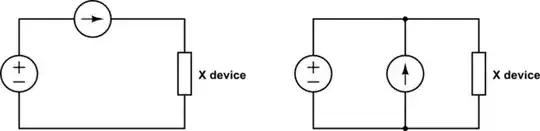

The problem here is that you assume we can test this device by impressing both current and voltage and this is impossible. You have only two terminals in your device, so you either connect an (ideal) voltage source or an (ideal) current source to them. Whatever complicated system you use to create those sources, they have only two accessible terminals to your device. The problem is that to impress the current you have to put the current source in series with your device, whereas to impress the voltage you have to put the voltage source in parallel with it. If you want to impress both quantities, you should be able to put both sources together, but the requirements are incompatible: you either connect both sources in series with your device or in parallel.
schematic
In the latter case the current source cannot impress the current in the device alone, whereas in the former the voltage source cannot impress the voltage across the device alone.
If you object that you could devise a strange "testing apparatus" that "magically" has only two terminals and puts out a fixed voltage across those terminals and impress a fixed current across them, well that is impossible either, because its V-I relationship would be a single point in V-I plane.
If you don't get why such a V-I relationship is absurd physically (mathematically is OK) think a moment about it: such a testing device is able to impress both a fixed current and a fixed voltage on whatever load it is connected to, so it is able to turn everything into a resistance of value R=V/I (that's magic!)
