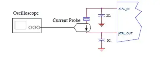

Every application note I have read on the subject says to measure with a current probe and calculate from there.
Measuring crystal drive strength with a current probe
Unfortunately, I don't have a current probe capable of measuring this signal.

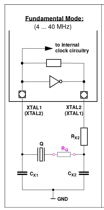

For example, would it be valid to measure the voltage across a small "R_Q" (e.g. 1R) on the below diagram? What pit-falls are there in using a method like this?

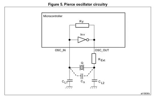

The STM32 Crystal Application Note AN2867 offers an alternate method in Section 3.5.2:
This current can be calculated by measuring the voltage swing at the amplifier input with a low-capacitance oscilloscope probe (no more than 1 pF). The amplifier input current is negligible with respect to the current through C_L1, so we can assume that the current through the crystal is equal to the current flowing through C_L1.
That is, measure the voltage at the non-inverting input to the amplifier (across capacitor C_L1), because the current through the load capacitor is essentially the same as the current through the crystal (since the amplifier is high-impedance).
The drive level can then be estimated as: $$ DL= \frac{ESR \times \left(\pi f C_{tot} \right)^2 \times \left(V_{pp}\right)^2}{2}$$ where $$ C_{tot} = C_{L1} + C_{s}/2 + C_{probe} $$ and ESR is from the crystal, Cs is the board stray capacitance, C_probe is the capacitance of the probe leads, and f is the frequency of operation.
I have not been able to verify this method against the current probe measurement, but it gives sensible values for an NXP S32K development kit (i.e. an 8MHz crystal with a measurement of 0.6Vpp gives a power estimate of 6uW).
