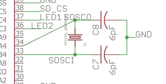

I'm trying to run an RTC off of an external crystal using a PIC, but the crystal isn't oscillating when I expect it to, and is oscillating under other circumstances, and I can't make any sense of it. I'm not an EE though, so I'm probably just being super ignorant.
The crystal: LFXTAL016178. I'm fairly certain that because nothing is listed, it's a parallel resonant crystal. Its load capacitance is 6 pF, which I've found to be sort of uncommon? I'm not sure.
The PIC: PIC24FJ128GB204. I've connected the crystal as the datasheet suggests, but it doesn't provide much explicit help in selecting load capacitors, so I did some searching and found other resources online to help me there.
The setup: I saw from a couple sources that a good rule of thumb for load capacitors is \$C_L = \frac{C_1 × C_2}{C_1+C_2}\$, adding stray capacitance to \$C_1\$ and \$C_2\$ of between 2 and 5 pF. I picked what I thought was a middle value of 6pF for both capacitors, and I'm still not sure how bad that selection was.

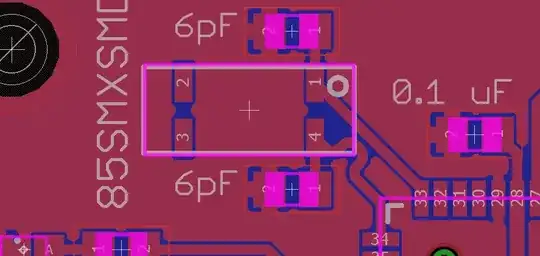

Here is a picture of my schematic: schematic Layout: layout

  • As it is in the schematic, with 6pF load capacitors on both pins, it doesn't oscillate. Unless it oscillates every 10 minutes or something.
  • With the capacitors removed, it oscillates extremely slowly, maybe approximately 2.5 times slower than it should. I didn't measure this speed.
  • With extra 6pF capacitors soldered on top to make 12pF capacitors, it doesn't oscillate.
  • With 3 pF capacitors and a 10 MOhm resistor across the pins. (RTCC clock is erratic.)

  • If you have spares, add the same caps in parallel to the existing ones to have 12 pF total for each. I don't think you need a pull-down. Are you planning to run a PIC off of this clock? – Oleg Mazurov Aug 11 '17 at 22:22
  • I did try that, to no avail. I'm running the PIC off of its own internal oscillator, this is just for the real time clock. – Andrew Elliott Aug 11 '17 at 22:26

  • I'm not certain how many pF of shunt capacitance you have between the tiny gap in copper traces across the xtal and caps but I would guess it is a few pF each. Which pin did you check for clock, input or output? Consider also probe capacitance. – Tony Stewart EE75 Aug 12 '17 at 04:33

There are two main things going on:
  1. You don't have enough load capacitance.
  2. You don't understand load capacitance.
Imagine one side of a crystal being driven with a sine wave at the crystal frequency. This signal is low impedance. The load capacitance is that capacitance you put on the other side of the crystal to cause a 180° phase shift.
The phase shift of such crystals varies quickly as a function of the frequency at the crystals operating frequency. Since the phase as a function of frequency is very steep right at the operating frequency, this is a good thing for the driving circuit to use to ensure the crystal is operating at the intended frequency. These types of circuits oscillate optimally when the crystal shifts the input phase by 180°. Since only a little frequency change messes that up, the resulting oscillation is very close to the crystal's intended frequency.
Now back to your circuit. The big clue is that things work when you put a scope probe on the oscillator input pin. What that is doing is adding capacitance on the output side of the crystal. Apparently, with the setup you have, the additional scope probe capacitance causes the crystal to shift the phase the appropriate amount for the system to oscillate. If you add more capacitance yourself to the crystal output only, you replicate the effect of the scope probe and things will work. Try another 10 pF or so for starters.
Don't use formulas you find on the other end of the internet without understanding them. The equation you show makes a bunch of assumption, some of them not valid. Unfortunately there is a lot of conventional stupidity out there regarding crystals.
The crystal by itself is only a two-terminal device and doesn't "know" anything about your circuit ground. Ultimately, the load capacitance is what is across its terminals. The conventional stupidity therefore says to use two equal capacitors on each side of the crystal to ground. Since these are in series, each need to be twice the desired capacitance. However, whatever stray capacitance to ground you think there is on each side of the crystal needs to be subtracted from these capacitances.
The problem with the conventional stupidity is that it ignores the impedance of the crystal driver output. Consider the extreme case where that is 0. In that case, the capacitance added on the input side of the crystal is completely irrelevant, since it is in parallel with the 0 impedance of the driver. The load on the crystal is then only the capacitance on its output.
Do some math. The impedance of 6 pF at 32.8 kHz is 810 kΩ. Now the impedance of the crystal driver is certainly not zero, but quite likely significant relative to 810 kΩ.
Consider what each of the caps really do. The one on the input loads the crystal driver. The main purpose of that is to attenuate some of the harmonics coming out of the driver. This beats on the crystal less, and makes it less likely that the whole system will oscillate at a harmonic. Crytals have complex transfer characteristics. They can have some of the same characteristics at harmonics as they do at the intended operating frequency. Some crystals are cut so as to deliberately enable use at harmonics, called overtone mode in the industry.
The capacitance on the output is the true "load" capacitance. Its reactance works against that of the crystal to phase shift the result the right amount at the right frequency.
In your case, the crystal is rated for 6 pF load, and that's what you put on its output. That should have worked. My guess what is happening is that the cap on the input of the crystal, really on the output of the crystal driver, also caused a phase shift that worked against that of the load cap. Just as a test, try removing the cap on the crystal input and leave the 6 pF on its output. It would be nice to see the waveshape on the crystal input then, but even a 10x scope probe might change it. Try it anyway, but make sure the scope probe is set to the highest impedance, therefore the lowest capacitance, possible.

  • I think 2. is correct but 1. is not. the trace gap load cap is too much and not split so that it allows the 1st cap to create a transmission LPF and prevent feedthru capacitance across resonator. reconsider pls – Tony Stewart EE75 Aug 21 '17 at 18:17

The MCU maker is likely at fault. There is absolutely no excuse for not designing a modern MCU RTC oscillator to reliably function with any typical commercially available 32kHz crystal.
Unfortunately, the opposite is much more common, as you have already discovered - in your case the MCU data sheet fails to mention that 6pF load capacitance does not work.
The root issue is that you are dealing with a system of two components, made by two different manufacturers. One of them speaks silicon and the other speaks quartz, and they have never properly agreed how to tell designers how their products reliably work together.
So, as you have found out, the crystal oscillator can be a trap for the unweary. I have seen a major automotive production line grind to a standstill because of crystal oscillator startup issues!
Anyways, to get to your question of WHY, there are four important parameters at stake:
  1. Output impedance of the MCU oscillator. This varies over frequency and is often complicatated by configuration bits such as "drive level" or "power level". I have never seen these values specified/guaranteed by any MCU maker.
  2. Input impedance of the external capacitor-crystal-capacitor "pi" network. This is primarily determined by the capacitor on the input side, which in turn is determined by the load capacitance specified by the crystal maker.
  3. Voltage gain of the (loaded) MCU oscillator at resonance. The oscillator gain has to make up for the ESR-induced loss of the external Pi network. This gain changes significantly over temperature, supply voltage and manufacturing batch. I have never seen this gain (and driver output impedance) properly specified /tested/guaranteed by any CPU maker. Some makers specify transconductance \$G_m\$ instead of voltage gain.
  4. Voltage gain (actually loss) of the external Cap-Xtal-Cap "Pi" circuit at resonance. This is primarily determined by the internal equivalent series resistance (ESR) of the crystal. The crystal you mentioned specifies ESR=50k. The resistance also increases over age (as moisture/impurties leak into the crystal case) and is also affected by soldering temperature/time. (Impurities in the crystal case evaporating & settling on the quartz) ESR can also vary significantly between manufacturing batches. 50k is a fairly typical ESR for a 32kHz crystal - the lowest I have seen specified at 32kHz for small form factor crystals is 30k.
For any oscillator to work, the total voltage gain, which is the the product of (3) and (4) must >1. In addition, the phase of the gain (yes, gain is a complex number) must be 360 degrees. About half of the phase, 180 degrees, is provided by the inverting amplifier, and the "second inversion" is provided by the cap-xtal-cap network.
Here's a simple online simulation that can help you get a feeling for how gain, output impedance and the capacitor values interact and affect startup. Right-click any component to change its value. (Note - this simulation uses 1mV residual capacitor voltage to fake startup, but in real life noise in the amplifier is the source of startup, like in this one)
So what happened in your case? Most likely, the MCU oscillator designer designed his output stage to reliably function with 12.5pF loaded crystals, and it turned out that at 6pF loading, either the voltage gain or phase requirements were simply not met. Since nothing about the design assumptions is stated in the data sheet, voila, problem for you - and many others.

Your only major design flaw was the copper fill around all tracks adds too much capacitance and reduces Phase shift feedback from 180 towards 90 deg where if the loop gain is insufficient, it will not oscillate or force a lower resonance. This layout forces you to choose a xtal requiring larger load caps for stability to satisfy Barkhausen criteria.
These track gaps ought to be same or no less than the gaps between IC pads as stray C gnd is inverse to gap.
