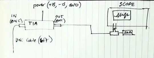

I'm investigating a noisy output of a Femto DHPCA-100 high speed transimpedance amplifier. The final application is to amplify the signal of a PMT tube, but the bulk of the noise can be reproduced without the PMT.
The test setup is shown below. The TIA is powered and the output is connected to a scope with a 50ohm terminator. The output of this amplifier is specified at +/-1V @ 50ohm load. The amplification level is set to 10^4, low noise setting. With the input left disconnected, the noise level is around 4mV pk-pk.
When a 6ft BNC cable is connected to the input - but left open at the other end - the noise level jumps to around 40mV pk-pk. This is plenty enough noise to conceal small input signals.

Is this standard behavior for a TIA?
Yes, unfortunately it is and no, your cable isn't acting as an antenna but as a capacitor. The cable capacitance is connected from -Vin to ground and this makes the non-inverting gain of your amplifier very large at high frequencies.
What has non-inverting gain got to do with a TIA I hear you ask possibly?
Well, in series with +Vin you have a noise source and this is the equivalent input noise source of your amplifier (op-amp) and, with zero capacitance on -Vin you have a non-inverting gain of unity.
Now add some capacitance and the non-inverting gain becomes: -
$$1+\dfrac{Rf}{X_C}$$
Clearly, as you add more capacitance, Xc gets smaller and the "noise gain" (yes, that's what it is called) gets bigger.

Is there any glaring error I am making with the configuration of the instrumentation? Are there any best practices to reduce noise of this variety?
YES!
The manual for that amplifier says the following:
Upper cut-off frequencies and equivalent input noise currents given in this table are typical values only which will depend on the source capacitance. Keep the source capacitance as low as possible by using short cables at the input to achieve best possible bandwidth and noise performance.
On a transimpedance amplifier it is absolutely essential that you keep the cable as short as possible. Some vendors spec a maximum length (often in inches). You're running it through feet of cable. That is not going to work.
