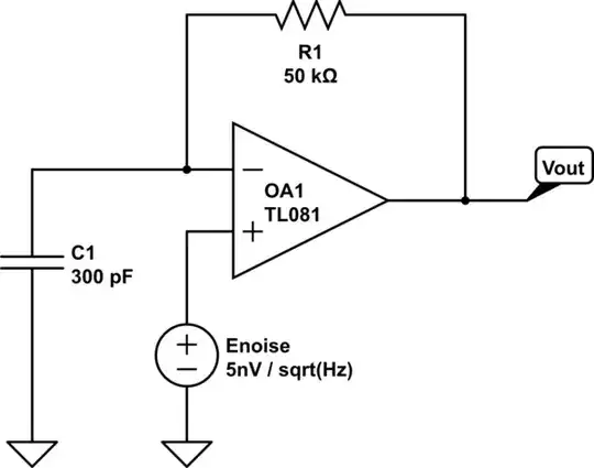

Anyway, the basic problem is going to be op-amp input voltage noise: -
schematic
C1 is the photodiodes self-capacitance and the op-amp input noise I've put on the non-inverting input because that's the easiest way to see the problem.
Clearly at low frequency the noise is barely amplified at all but, as frequency rises the gain of the circuit becomes: -
\$1 + \dfrac{R1}{\frac{1}{2\pi f C1}} = 1+ 2\pi f C1 R1\$
If C1 is 300pF and F is 300 kHz then the noise gain is about 29 and the output will be a mess. What is done to counteract this is beyond the scope of this question but it's called bootstrapping and quite often uses a JFET - this can cut capacitance down by about 10:1 and in the example above the noise gain would become about 4.
What about the op-amp's noise current - well, as frequency rises C1 shunts this more and more so it becomes less of an issue at high frequencies than at low frequencies but at low frequencies the noise current will produce an output that is current * R1 so you have to be aware of this.

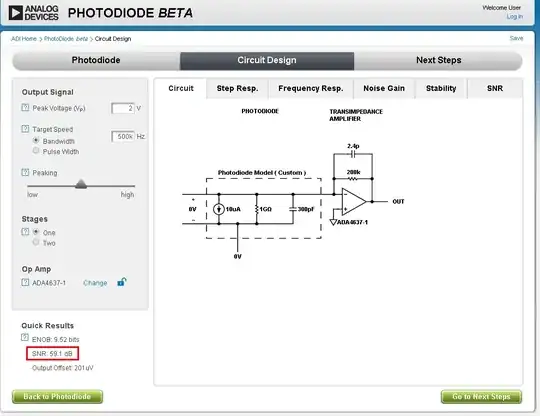

Analog Devices have a great tool for solving photodiode problems: -
Here I've chosen a photodiode with capacitance of 300pF, a photodiode current of 10uA and the site has picked an op-amp and done the calculations - it doesn't always pick the correct op-amp and you have the choice to choose different op-amps.
I've used this for a job and the numbers came out pretty much as the tool suggested.
