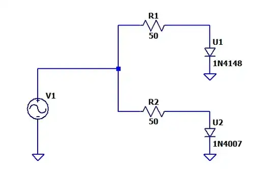

After encountering a nice example from an answer of this question, I wanted to simulate the same circuit in LTspice to compare the reverse recovery times of two diodes 1N4148 and 1N4007 by a 5V 100kHz square wave source:

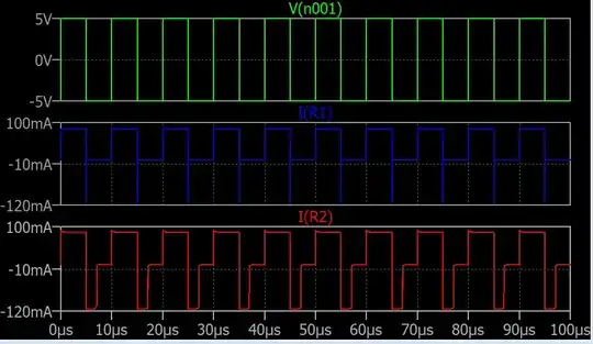

If I don't verify/set Trise and Tfall for the squarewave i.e if I use the default settings, I get the following plots for diode currents I(R1) and I(R2):
The above current plots doesn't tell me anything.

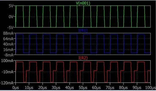

But if I set Trise and Tfall as 0.00000001 which is the 1/1000 of the square wave period, I get the following plots for the diode currents:
As you can see the fast recovery time of 1N4148 can be seen very explicitly.
What is the proper way to check reverse recovery time in LTspice/SPICE? I mean what should be the rise and fall times relative to the squarewave period?

  • Well the rise time shouldn't be longer than the recovery time. –  Mar 26 '18 at 20:10
  • Woow great point. I think this means then one better check this reverse recovery time from the data-sheet and then simulate(?). The default rise/fall settings of LTspice are not revealing this recovery time. – user16307 Mar 26 '18 at 20:13
  • @user16307 If by "default" settings for rise/fall times you mean that you set them to zero, then you're in for a surprise, as LTspice sets them at 10% of Ton. For a 5us Ton, they will be 0.5u, which means the total pulse (50%rise->50%fall) will be Ton+10%Ton=5.5us. The solution is to impose values for Trise/Tfall, but there's no need to exaggerate. For example, a 0.1% of Tperiod will suffice in most of the cases. Here, Tperiod=10u, Ton=5u => Trise=Tfall=10n (your values, congratulations), and also account for 50%rise->50%fall: Ton=Ton-Trise=5u-10n=4.99u. – a concerned citizen Mar 27 '18 at 07:35
  • @aconcernedcitizen I found your comment very helpful. Can you write it as an answer so I can select it? – user16307 Mar 30 '18 at 16:39
In LTspice, setting the rise and fall times of a pulse source to zero will not mean that they will be null, as that will be both a physical impossibility, and a machine problem -- a low and a high cannot coexist in the same time. So, LTspice circumvents this by setting them to 10% of the Ton.
In your case, you have Tperiod=10u and Ton=5u, which means that Tfall/Trise will be 0.1*Ton=0.5u. This also means that the total pulse width, calculated from the time it reaches 50% of the rising time, until 50% of the falling time, gets to be Ton+(Trise+Tfall)/2=5u+(0.5u+0.5u)/2=5.5u.
The solution is to impose values for Trise/Tfall, but in a sensible way. For example, a 0.1% or Tperiod will, in most cases, suffice, while also not be a burden to the solver, by creating unnecessary steep transients that may cause slow downs around those points, or even failures in the form of timestep too small. Adapting this to your requirements: 0.1%*Tperiod=10u/1000=10n (the values you have chosen, congratulations). Now, to account for the total pulse width (considering Trise=Tfall): Ton=Ton-Trise=5u-10n=4.99u. If, for example, Trise=2*Tfall=20n, then the pulse width would have been 5u-(10n+30n)/2=4.98u.
Of course, nobody says you can't set Trise=Tfall=1ps, or less. LTspice will comply, but, as mentioned, you may regret it.
One last thing to mention: LTspice uses a modified nodal analysis for its matrix solver, so that means it's working with conductances (1/R), rather than resistances (R), which also means that voltage sources, with their default (machine) zero resistance, may cause problems (as mentioned by the manual, see the E-sources, bottom). LTspice's solution for this is the parasitics, Rser and/or Cpar, but Rser is the one that matters. When set, it will be converted, internally, into a current source, thus having much higher chances of convergence. For your case, it's unlikely this will be needed, but it's not a bad thing to remember. Also, since you manually inserted series resistances, this will, most probably, not be necessary.
So, with these in mind, you can test your diodes as you see fit. You may want to impose a tight(er) timestep, while also only using a period, or two (no need for more). .opt plotwinsize=0 may also be of a help in studying short periods of time with the waveform viewer.
