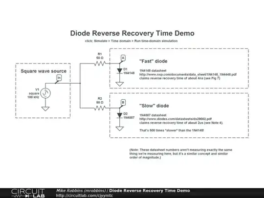

I put together a little simulation of reverse recovery time in a 1N4007 diode vs a 1N4148:
reverse recovery time demo
The demo shows the diodes being switched under a square wave, and shows that the 1N4007 takes a few microseconds to turn completely off!
