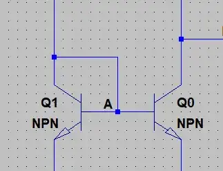

I am trying to size the Q1-Q0 current mirror pair so that the emitter area of Q0 is N time as large as that of Q1. If I try to change the model of the 2N2222 NPN transistor (for example by changing the ratio Is, the saturation current, of Q1-Q0), then this change would apply to all 2N2222 NPN transistors in the circuit. I was wondering if there is any way to design/size a "single" transistor or MOSFET component?

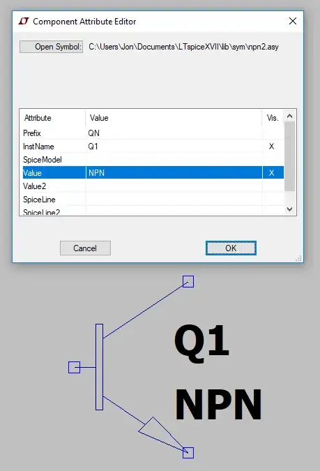

Another approach is to drop down a regular schematic symbol (BJT or MOSFET) and then right-click on the Value (for example, the "NPN" that shows when you first add an NPN BJT to the schematic.) To begin, you will see something like the following if you do it correctly:
Here, change it to some special model name you want to create. Like "MYNPN" for example.
You can also control-right-click on the symbol and you will see, under "Value", a designation there that you can now edit. If you choose this method, the display will look something like:
Either approach works. The main thing is to change this name to something that isn't found anywhere else. Make up a name.

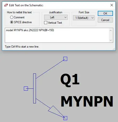

Once you have a named part, like this, you can now add a "card" on your schematic. You do this by hitting the "S" key. A dialog pops up looking like this:
Note that I've added some text. This text tells Spice that I want to define a new "model" of a device. I provide the name for it (MYNPN) and then use "ako:" to tell Spice to grab up a default model that I'd like to modify. In this case I used "2N2222" which happens to be in the standard BJT library. Then I specify the NPN() part at the end. Here, I can insert any specific parameters I'd like to over-ride in my own special model. The other parameters, those that I don't over-ride, will remain the same as in the default model I mentioned already.
Now, you have a new model on the schematic and LTSpice will demand that you place this new "card" on the schematic somewhere. Stick it in any convenient place. Location doesn't matter.
You can always right-click on these "cards" to change them, too. So you aren't stuck with mistakes you might make.
You could also NOT use the "ako:" keyword and instead just fill out the entire NPN() part of the "card." It is your call how you want to do that. If you use "ako:" then you get to pull up a bunch of default values that are similar to where you are headed and only modify the parameters you want to modify. If you don't use that keyword, then there still are defaults but now these are hard-coded ones deep inside of LTSpice and listed in the help file on the BJT. Either way, you over-ride the parameters you want to over-ride.

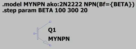

You can also parameterize them and make LTSpice go through a range of values. For example, you can tell LTSpice that you want the \$\beta\$ of a transistor to be varied from 100 to 300. You do this by setting up a new parameter value and using it within your .model card.
For example,
That shows two cards. One for the model, which refers to the parameter name BETA as an expression rather than a hard-coded value. Then I added a .step card which causes the parameter value to be modified repeatedly, starting at 100 and going to 300 in steps of 20.

  • Sorry for my late response, and for my English if the last sentence was not close to what I was trying to do. Actually I was trying to size the current-mirror pair so that one BJT Q0 "copies", say, 10 times larger current from its pair BJT Q1. So I was trying to size the ratio of Q0-Q1 emitter area to achieve the above task. I was just wondering if there is a quick way to do so? – IgNite Dec 31 '17 at 07:38
  • Another example, quite off-topic but should demonstrate what I was trying to do, is when we wish to size the CMOS gate so that the rise and the fall time delays are equal. For example, for the inverter gate, we usually size the width W of PMOS to be x times wider than that of the NMOS to account for the lower mobility of PMOS and other factors. I was just wondering if we can do this in LTspice without naming a new model every time and use AKO keyword. Or this must be done during the layout phase? Hmm... I guess no because we need simulation first. – IgNite Dec 31 '17 at 07:51
  • By the way, your answer is helpful and as of now its (renamimg and using AKO keyword) the only way I can do so. I'll accept your answer. – IgNite Dec 31 '17 at 07:53
