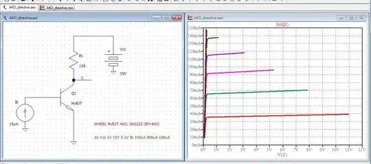

Here is an hastily conceived simulation that shows what I told you:
As you can see, I just changed the value of Bf for the "AKO model" and this reflected on the output characteristics as you would expect from that change.
