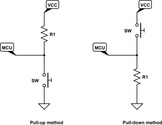

During a meeting for a particular project I was asked to think about the way to detect a push on a button with a MCU. The detection should consume as little power as possible. At the first glance, I thought the typical circuit with a pull-up or a pull-down :
schematic
I don't account for some anti-bounce features here, as that is beyond this question's scope. In either case, when the button is pushed, the total current value that flows depends on the resistor value. To minimize it (the current), I could increase the resistor value but not so much since, if I am right, it also depends on the input pin leakage value. Plus, a large resistor would recover slowly.
My question is the following one : what are the smart ways to detect a button pressed that doesn't consume power (typically for a high power consuming application)? Are there any methods that are barely power-consuming when the button is pressed?

    A pull-down of 10k consumes nearly no power. 3.3V gives 330uA. And on most modern MCUs you have the option to set one internally, which will have even higher resistance. That being said, you can activate the button supply from a MCU pin through a BJT or MOSFET. Only activate it during the read, and read with polling. – Lundin Dec 12 '17 at 15:14
  • 29
    @Lundin In "modern" terms, 330 $ \mu $A may be a high current... – awjlogan Dec 12 '17 at 16:15
    indeed, many microcontrollers can get sleep currents as low as 2-10 μA. Wasting 30x that on a single pull-down is kind of sad, especially in a battery powered situation. – whatsisname Dec 12 '17 at 22:11
    How big a resistor you can use on a pull down depends on the pin impedance and at what voltage they switch. Let's say you have a 3.3v pin in a high impedance state that switches at 2.4v, all you really need is slightly lower impedance than the input. I would recommend you attach a potentiometer and measure how high value of a resistor you can use for the pin to keep working reliably, and then go 20% lower in value to keep a margin. – Drunken Code Monkey Dec 13 '17 at 05:40

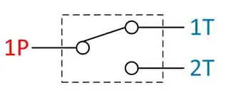

A SPDT (Single Pole Double Throw) button would be your ultra efficient button.
Source: http://www.ni.com/white-paper/3960/en/
In your case the 1P would go to the MCU, the 1T to VCC, the 2T to GND.

  • +1.. it has always bugged me that subminiature SPDTs are either very hard to find or cost way too much... – Trevor_G Dec 12 '17 at 16:03
    @Trevor Yeah... some things are sadly very overpriced. While other items are underpriced (MCU for an example). You can't have it all. – Harry Svensson Dec 12 '17 at 18:16
  • This is a great idea. Sadly I didn't manage to find a SPDT CMS button that fit my needs. I'll keep this circuit in mind though – vionyst Dec 21 '17 at 07:57

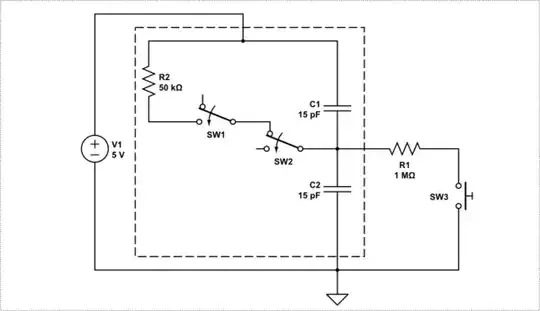

One method I have used takes advantage of the capacitive nature of CMOS inputs.
schematic
In the circuit above the switch, when closed, allows the pull-down resistor to charge/discharge the input capacitances of the GPIO down to ground level.
The trick with this circuit is to use the bidirectional nature of a GPIO to keep the input charged to a logic high level when the switch is open.
The control routine periodically turns the pin out as a high level, or briefly enables the pull-up, long enough to maintain a charge the caps. The input pin then acts like a dynamic memory bit and will, with most devices, hold that charge for a considerable and usable amount of time.
When configured properly, if the button is pressed the charge on the pin will discharge faster than the refresh rate. That condition can then be detected as part of the refresh algorithm as a read before refresh operation, or used to drive an interrupt.
Power is briefly used during the refresh pulse, both to recharge the capacitors and through the resistor and switch if it is closed. However, the length of the refresh pulse is short and the polling frequency results in the refresh current being relatively insignificant.
Obviously this method is an active one. If the micro is put to sleep, the state of the switch will be indeterminate on waking. The first refresh cycle after wake-up must ignore the pin read. Also, this method should not be used to wake the micro. Before going to bed, it is also wise to enable the pin as a low output to park it in a zero current state.
For reading more static switches, like set-up dip-switches, a dedicated routine can be used rather than a continuous refresh cycle. After reading, the GPIO pins should then be "parked" in an active low output state (zero current) to avoid the floating inputs issue.
NOTE: This technique does suffer a little from noise sensitivity if the trace lengths are long and travel through a noisy area. As such R1 should be close to the input pin. However, I would not recommend it for hooking up a switch some distance away on a front panel somewhere unless you add extra capacitance close to the pin.

    This looks very vulnerable to EMI indeed. If any form of radio energy getting inside that circuit and I think all bets are off. Good thing wireless stuff isn't that common nowadays :) – Lundin Dec 12 '17 at 15:22
    @Lundin it's not as bad as you might think. 30pF and a meg make a rather good filter. – Trevor_G Dec 12 '17 at 15:39

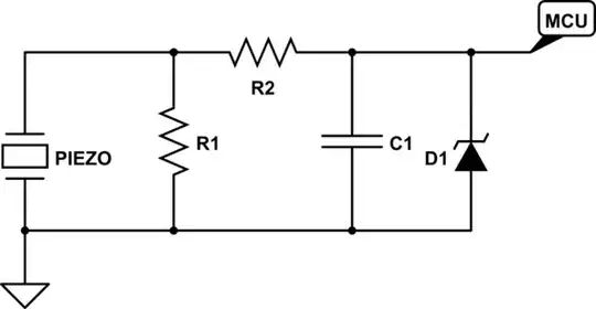

If your button is a piezo switch, then the only power required is the power generated by pressing the button.
For example: R2/C1 collect the energy produced by pressing the piezo. D1 prevents the C1 voltage getting too high. R1 drains C1 when the button is released. The MCU GPIO must be in input, no pull mode. Voilà, button detect with zero current draw from the supply.

    Hmm, can you to make/design a working prototype of that and show the benefit from the solutions with a normal switch we've been using for the last 30 years? – Bimpelrekkie Dec 12 '17 at 12:43
  • Sure. I've added an example schematic. Simply build that. Benefit is that there is zero current draw from the supply in either closed or open state. Disadvantages include poor control of the effort required to activate the switch (an active circuit would be better, but that foils the circuit's very marginal benefit), and it being a novel design compared to the 30 (300?) year old normal switch design. – Heath Raftery Dec 12 '17 at 19:19
  • Still, my calculator has lots of buttons and runs at least 5 years on a coin cell. Still not seeing how your solution would bring any benefit to that. I still think it is a "solution" to a non-existing problem. And more costly as well. – Bimpelrekkie Dec 12 '17 at 21:06
    Oh I agree! It meets the original criteria "consume as little power as possible", but why saving less than a millijoule is actually useful is hard to imagine. – Heath Raftery Dec 13 '17 at 22:23
  • Doesn't the input impedance of the MCU do nasty stuff because of the high output impedance of the piezo? – Scott Seidman Dec 14 '17 at 03:38
  • @ScottSeidman Indeed without additional protection you could get quite high voltages at the MCU's input. These inputs are ESD protected though (by on-chip ESD diodes) so above a couple of volt the input is no longer high-impedance. It depends how much energy is coming from the piezo element if the ESD protection can handle that. To be safe the circuit as shown above is needed. With the correct component values it will be quite hard to damage the MCU input with this protection in place. – Bimpelrekkie Dec 14 '17 at 06:48

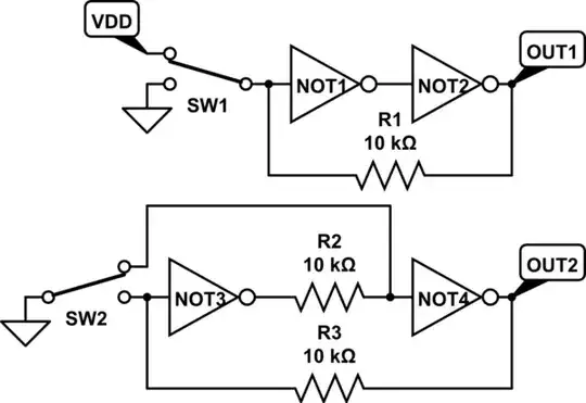

If the device needs to be able to stay in either state indefinitely, using an SPDT switch will be the lowest-power approach, since a static circuit can be made to draw no current beyond its own internal leakage and that of the switch. An additional advantage of SPDT switches is that they can be almost perfectly debounced, no matter how quickly they are operated or how crummy the contacts might be, provided only that one contact stops bouncing before the other one first reads as closed.
There are two good approaches to wiring up such switches:
schematic
The first approach requires one less resistor than the second, but the second will be more tolerant of overlap between the two poles (it will draw higher than usual current, but won't put a dead short across the supply). Note that if the switch can enter a state which is moderately resistive for a prolonged period of time, that could burn a significantly more current than usual, but during normal usage none of the resistors will carry any significant current except during the brief moment between the time the switch changes state and the output responds.
