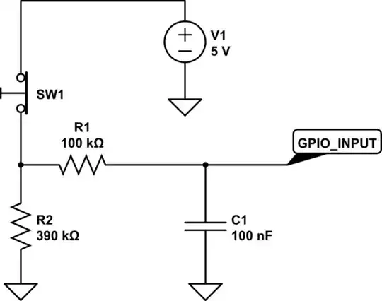

One way to calculate it is to look at the maximum GPIO voltage that is not guaranteed to be interpreted as "low", and subtract some noise margin (say 500mV). Then use the maximum GPIO leakage specification (being careful, in both cases, to check that the limits apply over the temperature range) and calculate the maximum resistor value.
Let's take the ATmega328p as an example, and assume Vdd = 5V.
The first number is 0.2Vcc, so 1.0V. Subtract 500mV and we have 0.5V.
The maximum leakage is 1.0uA.
So a resistor of 500k\$\Omega\$ maximum would be acceptable from a leakage point of view. Some kind of RC filter would be a good idea at those levels. A 100nF capacitor has an impedance of about 26k\$\Omega\$ at 60Hz so even a small capacitor would help.
In practice, to avoid noise pickup and other potential issues, unless power saving is an overriding consideration, it's usually better to keep the value under 100k\$\Omega\$, and more like 5k~50k\$\Omega\$. Internal pullup/pulldowns are typically in the 50k\$\Omega\$ range, which is toward the higher end of what is good from a noise pov.
To help with ESD (and in case the GPIO somehow gets switched to a low output, some series resistance on the input is not bad idea, however that means that your reistor has to be lower in value. Something like this:
schematic
It takes some milliseconds to tens of ms to respond with this circuit, and much faster response to the switch conducting (released) than not conducting (pressed).
The really careful/paranoid designer would add another resistor after the 100nF capacitor of perhaps 510 ohms to limit the transient input current to less than 10mA in case the power supply is shorted.
Another technique if you don't need fast response would be to use the above circuit but replace V1 with another GPIO set to output and initially set low (zero current draw). You could then reduce the resistors R2 to (say) 4.7K, and R1 to 4.7K. You can reduce the capacitor to (say) 1nF. Then the time constant is ~10usec. Then you could periodically (say ten times a second) pulse the GPIO output high for (say) 50usec and read the input at the end of the 50us period, then return the output to the low state.
Average current would be perhaps 1.2mA during the pulse and the duty cycle is 50E-6/0.1 = 0.05% so average draw is ~600nA, yet the switch sees a healthy ~1mA.

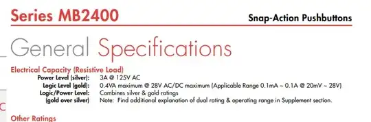

Note: The current through the switch is less than 13uA with the above schematic. While that's nice from a power saving pov (and simple), many switches require a much higher current to operate reliably. For example, this decent quality NKK switch requires 100uA (Au contacts) or an unspecified (much higher) current (Ag contacts):
If the minimum current is not specified you should not assume it's less than the mA range. And obviously once the Au contacts have been used for switching a power load they no longer likely will be reliable switching microamperes since the thin gold plating will be gone.

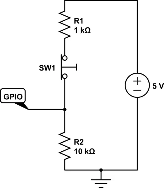

You could add a another resistor to create a voltage divider:
schematic
Here I've added a 10k between the IO pin and ground, which means when the switch is closed (normal operation) the IO pin will "see" the result of
$$\frac{V_s\times R_2}{(R_1 + R_2)}$$
Which is about 4.5 volts, which should be just fine for a logic true. When the switch is opened, the IO pin will be pulled instead to ground by the 10k.
When the switch is closed as usual, 11k of resistance will result in about 455 µA of current flowing, which is fairly low.
If you are designing a device that's meant to last for years with a battery, that amount of current may be unacceptable. In that case, you can try increasing both resistor values to achieve an even lower current. If you think of the GPIO pin of your microcontroller as being the gate of a transistor (which it basically is), then you need some current to flow in order to charge or discharge that gate and be discerned as a signal instead of noise.
Another, more complicated option is to replace R2 with another GPIO pin that's configured for output and set low. That gives you the option to, in firmware, change the function of that pin between acting as ground connection and being "disconnected" (high impedance).
