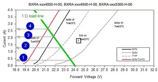

Typical isn't good enough in this case. A look at the I/V curve shows that \$ V_f \$ varies at 2.1 A from about 20.8 V to > 26 V.
Figure 1. \$ V_f \$ for the 5300 series lamps.
There are four curves given from MAX Vf through "typical" to MIN Vf all at 25°C. Then there is the red line at 70°C.
The green load-line represents your 1 Ω resistor. It will drop 1 V/A so at 4 A the voltage will have dropped to 20 V. The voltage and current for each LED curve can be estimated by the intersection of the curve with the load-line.
  1. With worst-case maximum Vf you can expect 0.4 A.
  2. The typical case would draw 1.3 A.
  3. The minimum Vf at 25°C would draw 2.1 A.
  4. As the LEDs heat up to 70°C the current increases to 2.6 A. This, of course, will make the LEDs hotter, the Vf will drop and the current increase until something gives up - the PSU, the resistor or the LEDs.
The problem is that you haven't enough headroom for a simple resistive current limiter. If you had several more volts available the load-line wouldn't be so steep and the current wouldn't vary so much.
