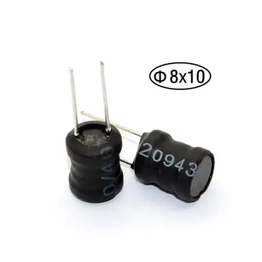

Inductors I'm using:

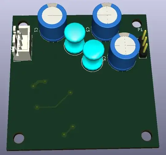

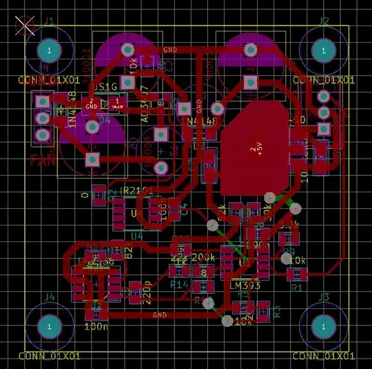

This is the layout (upper part is the buck convertor, fan connector at the left side, 12V power input at the right side):
enter image description here enter image description here enter image description here I used generic electrolytic capacitors. I have no datasheet for them.

    Please post a picture of the layout, capacitors are only effective at HF filtering if their inductance is low, which depends a lot on layout. Also, please give a datasheet for the caps (if they're general-purpose caps just say so) – bobflux Oct 09 '17 at 13:00
  • @peufeu I have added those updates. – Chupacabras Oct 09 '17 at 13:42

Adding to the other answers after your PCB layout update:
Without a ground plane to create a low inductance ground, every track labeled "GND" will have quite high inductance, about 7nH/cm for a 1mm wide track.
Thus the caps are inefficient at filtering HF, because little inductors (also known as traces) are in series with the caps, increasing their HF impedance. A SMD ceramic cap has a much lower inductance than an electrolytic, not due to magic but simply because it is smaller, so it will be better at HF decoupling... however the inductance of the traces is still in series.
Additionally, since you have fast di/dt currents in your GND, the potential along the GND traces will vary all over the place. Remember:
e=L di/dt
di = 100mA, dt = 20ns (fast switching FET), L=6nH per cm, thus e= about 50mV per 10nH of trace inductance... not exactly "low-noise".
...thus on such a PCB without a ground plane, when fats high currents are involved, it is usually impossible to measure anything, because the signal shape will change a lot depending on where you probe the ground.
As you noticed, the solution is not to have any HF and high di/dt currents in yoru circuit to begin with, and this is achieved by slowing down the FET switching with a resistor.
If your PWM is slow enough (say, 30 kHz) switching losses will be very small anyway.
This has the extra benefit of not sending high di/dt pulses into the fan wires, which prevents them from acting as antennas and radiating noise all over the place, which would be an excellent way to build a wideband radio jammer...

  • Thanks for your valuable answer. I made this circuit to be single sided (simpler to make it for me), and I know it looks ugly. Are you sure ground plane would make any difference? 1mm thick track has 7nH/cm, but 10mm thick track would have 3nH/cm. My circuit was working with 130kHz switching frequency. The reason for that was not efficiency, but the size of switching inductor. When I lower frequency from 130kHz to 30kHz I would need 4x bigger inductor (otherwise it will saturate). You are right on the rise/fall times. I changed fall times from 10ns to 100ns, and the noise went to 2mV p-p. – Chupacabras Oct 10 '17 at 19:49
  • Inductance of a plane is much lower than traces (don't use the flat conductor calculator, it won't work on a plane). Anyway, switching slower is the best solution in your case. You could also use double sided, if you want to etch it yourself, simply allocate the whole back side for ground, drill ground vias and put a bit of wire in it... it'll work. – bobflux Oct 10 '17 at 20:03
  • Yes, I'm etching it myself. Irony is that my first two versions had GND zone on both sides. I do not remember the reason. It's probably time to return it back :) – Chupacabras Oct 10 '17 at 20:38
  • Yeah, copper is free – bobflux Oct 10 '17 at 20:42
