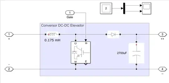

First of all I already have the closed loop control for the converter. My problem is not the operation, I can control the voltage, but I have doubts if it is correct to subject the battery to high current frequency variations as is happening. Below I show how I designed the parameters of the converter, as I did just for the boost, since according to the principle of power conservation the components must be the same for bust, changing only the switching of the IGBTs. I'm not sure if this is true, I do not know if it's what happens in real life for the application I'm doing, I need a lot of tips and references for it, not is the type of information found in papers or books.
Parameters
Rated Power = 10kW
Rated Voltage = 250 V
Vbattery = 144 V
Fsw = 25kHz
Ripple Voltage in capacitor = 0.1%
Ripple Current in Inductor (That's my doubt) = 20%
ΔiL = 13.8889
Lmin = 1.7584e-05
L (considering the ΔiL) = 1.7584e-04
C = 0.0027
These are the values calculated on the basis of the specifications that I have dubiously determined.

  • Simulink Circuit
Simulated Circuit

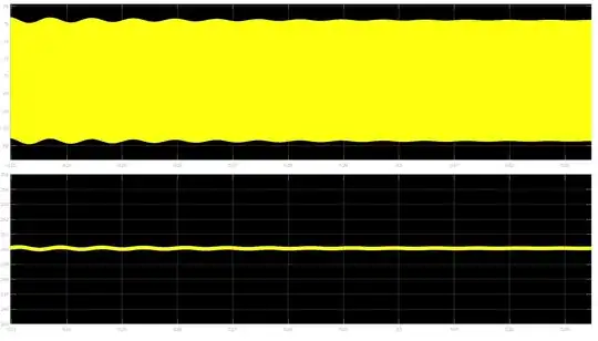

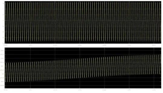

The plots below show the CURRENT (TOP) and VOLTAGE(DONW) in differents scales
  • Result with a zoom out
  • Result with zoom enter image description here
  • More closely enter image description here

I do not expect the ripple current in the inductor to affect the peak battery current. You will need to put a lot of caps near the input of your converter, so that they can provide the AC peaks while the battery will only see the DC. This also helps a bit for load transients.
The switching frequency entirely depends on the coil size, saturation current, output current, duty limits, vin, vout. But you have it the other way around: usually the switching frequency is given, as vin, vout, current requirements and duty limits, and then you select the coil.
Vladimir Cravero
  • 16,395
  • 39
  • 73
  • Could you plese be more specific about the "lot of caps" in the input of converter ? You mean a capacitor bank (capacitors in parallel?) – SrnLord May 10 '18 at 11:06
  • I do not necessarily mean a capacitor bank. It is difficult being more precise without knowing the PDN of the input supply... My point is that you do not need to worry of the AC current in the battery if you put a cap in the input of the converter. – Vladimir Cravero May 10 '18 at 11:40
