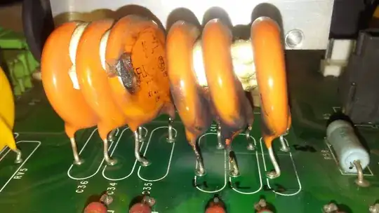

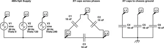

Please help me understand this. In a prominent, 480v, 6kW AC servo drive, across three input phases, three 22mm "XY" class 10nF caps are placed for EMI suppression. Also, from these three phases, three of the exact same "XY" caps go to chassis ground:
schematic
Now it is my understanding that "X" rated caps are designed to fail shorted to take out a fuse. So "X" should be used in the phases. And "Y" rated caps are designed to fail open so as to not electrocute anybody. So "Y" should be used from the phases to ground. Obviously, we cannot be doing both here... so what is an "XY" rated safety capacitor, exactly?
The usage of 400/500v-rated safety caps on a 480v bus: Thinking this needs re-engineered...

    According to KEMET, you can have both "KEMET 900 Series Safety Disc Capacitors are offered with a combination designation such as X1/Y1. This simply indicates that the capacitor can be used as an X1 capacitor in a line-to-line application, or as a Y1 capacitor in a line-to-ground application. KEMET offers both X1/Y1 and X1/Y2 class combinations." Link here : http://www.kemet.com/Lists/FileStore/900%20Series%20Product%20Training%20Module.pdf – Tyler Oct 06 '17 at 13:34
    Just a note that the above image was of a servo drive which had experienced a voltage surge, perhaps lightning. The caps do not routinely fail. Still, I was alarmed to see damage to both the across-the-phases group, and the caps-to-ground group. – rdtsc Sep 13 '18 at 01:17

  • I've got 5 DC-DC converters here with bad RIFA caps all over them. Every single one of them has crazed, and in more than one instance, it is obvious that they are no longer sealed. I do NOT expect to see a film cap that is bulging! – GB - AE7OO Dec 31 '19 at 00:45
