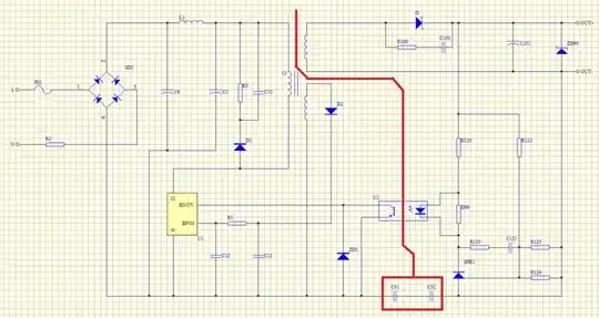

The data sheet for the power supply module shows this circuit that I've red-lined: -
I would be interested in ensuring that the two capacitors in the red box were Y1 \$\color{red}{\text{(amended)}}\$ rated and that there are sufficient clearances across the red line inside the module before using it. I would naturally assume that these things are in order on normal supplies from Traco, XP, Murata (i.e. the usual people who sell these things) but, there is nothing on your link about the quality of the goods you have bought so, do some homework and find things out. When your mind is rested on these things and everything looks in order then you can connect L and N either way round.
What is the worst thing that can happen if N and L are mixed up?
Electrocution if the module is made by some back-street outfit who don't know what they are doing so, do your homework and prove to your own satisfaction that they have a QA system that meets ISO 9000.
To me, they look dodgy and I wouldn't touch them with a barge-pole wired either way round but, you might have "insider" information that I don't have.
