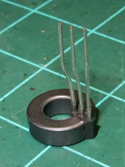

Figure 2. A home-made Hall current sensor. The wire to be monitored is passed through the core centre. The chip measures the flux density across the core gap and an output voltage is generated proportional to the current.

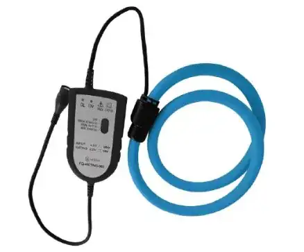

Figure 2. A Rowgowski 'scope current probe. Source: GFUVE.
