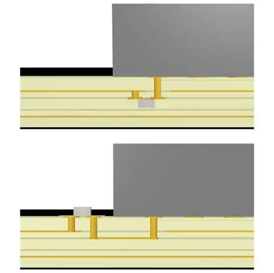

You don't have to have actives on an ASIC (although I don't know if anyone has ever done this). There are manufacturers who will do this kind of thing, it is expensive and you need large quantities.
There are better ways that would still be more costly than a PCB with components but cheaper than an ASIC. Components can be built inside the PCB.
Source: EDN

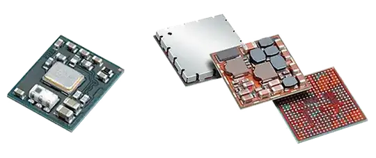

Or you can get integrated packages:
These last two would probably be cheaper than an integrated circuit where the passives are built into silicon, however embedding components in these new processes will be much more expensive than using a PCB with micro vias and stacking PCB's
