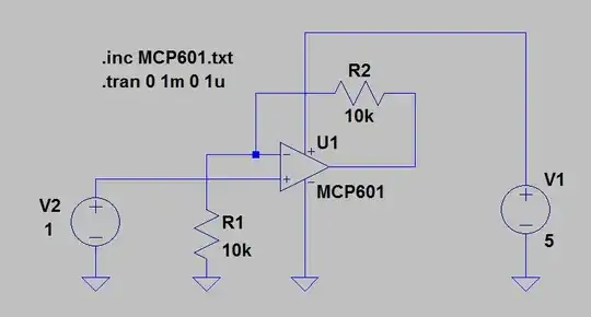

Here is my setup:
XU1 N004 N002 N001 0 N003 MCP601
V1 N001 0 5
V2 N004 0 1
R1 N002 0 10k
R2 N003 N002 10k
.inc MCP601.txt
.tran 0 1m 0 1u
.backanno
.end

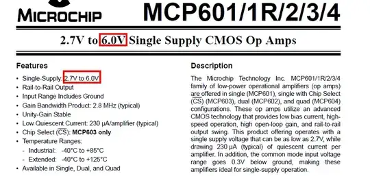

There could be a significant clue in page 1 of the data sheet: -
You appear to want to apply +/- 5 volt supplies to it in your sim. If lowering the supply to the correct range doesn't work try putting 10 ohm in series with the signal source V1.
EDIT following change to OP's circuit: -
Now the non-inverting input is being asked to handle the negative part of the input sinewave when the most negative supply of the op-amp is 0 volts.

  • My apologies. I've updated the circuit. I'm afraid it does not change the outcome though. – Chris-Al Aug 15 '17 at 17:01
  • Now you are asking an op-amp to amplify a signal that goes below the negative rail of the device. You can't expect this to work correctly either. Try adding a DC offset of 2.5 volts to your input signal. – Andy aka Aug 15 '17 at 17:04
