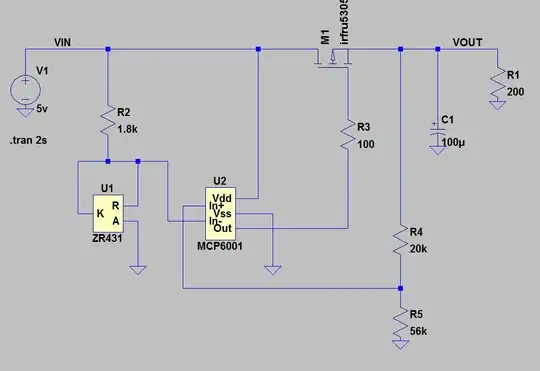

I am trying to simulate a LDO with Microchip MCP6001 operational amplifier in LtSpice. With other OA simulation is ok, but with all Microchip models, the same error:
Time step too small; Initial timepoint: trouble with u2:nmi-instance m:u2:12

And here my schematic enter image description here
I guess there is something wrong with the model, but I am not expert in spice to solve it. Thank you in advance,

  • It seems to me you swapped in+ and in- – Vladimir Cravero Feb 13 '17 at 12:47
  • nope, I tried both ways (swap In+ and In-) and the same result error. However, I used notation from original Microchip file. – yo3hcv Feb 13 '17 at 13:04
  • Sorry, my bad, that's a PMOS, polarity is correct. – Vladimir Cravero Feb 13 '17 at 13:08
  • only the Microchip files are not working, I tried the same import with TI's OA, ST and others. Suspect that in spice file is the problem but I don't know what is wrong. – yo3hcv Feb 13 '17 at 13:32
  • Well, can you tell my why your PMOS is wrongly connected? – G36 Feb 13 '17 at 16:03
  • Also, you can try to use LT1797 instead of MCP6001 – G36 Feb 13 '17 at 16:37
  • The models from Microchip are ones that are notoriously unfriendly LTspice-wise (and, I'm told, SPICE-wise, generally). – a concerned citizen Feb 14 '17 at 07:48
  • @G36 Mosfet it's is not wrongly connected, check LP2975 datasheet. My replica is a discrete LDO and at least in simulation, works wonderful :) I know, all Linear products are working nice, absolute correct datasheets, but 10x price :) – yo3hcv Feb 14 '17 at 08:07
  • @a concerned citizen... hmm, too bad. I found LMV321 at reasonable price and simulation is ok, so their loss. – yo3hcv Feb 14 '17 at 08:09
  • Can you explain me how can this circuit work if the Source terminal is connected to the output node (3.3V)? LP2975 data sheet clearly shows that the MOS Source should be connected the input node (Vin = 5V). – G36 Feb 14 '17 at 13:37

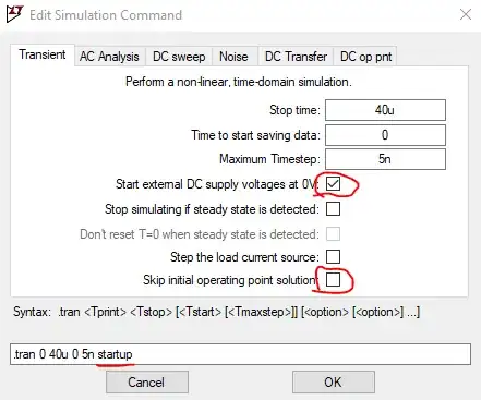

Old thread but the question remains. I had the same issue and finally I solved my own issue. I post my findins here in case it helps anyone else googling the issue.
NOTE: This applies only to issues related to "Initial timepoint" Short answer, try:
  1. Check "Start external DC supply voltages at 0V"
  2. Un-check "Skip initial operating point solution"
Why does this help? My guess is that the problem is two-fold.
a. If you cannot find a stable operating point (self-oscillating circuits may not have a stable operating point) you must "Skip initial op point".
b. Without a stable op-point all capacitors and coils are initiated at 0V and 0A. Then applying supply-voltages as a step at the initial timepoint may cause numerical problems
But when using "Start external DC supply voltages at 0V" the self-oscillating cirtuits will not oscillate and an operating point can be found. And because the voltage sources are applied as a ramp (default during 20us) there will be no infinite derivates and the simulation seems to work much more stable.
