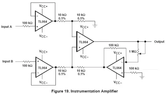

I'm reading through the datasheet for the TL064, which contains this figure on page 16:
TL064 Datasheet Figure 19
This is an instrumentation amplifier that apparently uses an inverting amplifier's output instead of a ground in the lower-right corner of the above figure, but what really perplexes me is the 100 kΩ resistors attached directly to the noninverting inputs of three of the four amps. I don't recall seeing an instrumentation amplifier circuit in books or application notes that have them, and all of the instrumentation amplifiers I've built using the three op-amp scheme work fine without them.
The datasheets specifies an input resistance of 1012 Ω, which is 10,000,000 times greater than 100 kΩ, so it doesn't seem to add anything to the already high-impedance JFET inputs. I thought perhaps it has something to do with input bias currents, but that's just me making a wild stab in the dark.
Curiously, figure 26 in the same datasheet (page 18) shows a two-op-amp version of an instrumentation amplifier without the 100 kΩ resistors at the noninverting op-amp inputs!
What's the purpose of the 100 kΩ resistors at the noninverting inputs in the above circuit? Am I missing something completely obvious?

IMO they serve no purpose, and they can be left out. If they were to minimize input offset, then there should also be one in the feedback from the output to the inverting input. Both inputs should see the same impedance.
Especially with very high input impedances like FET opamps there seems to be no need for them.

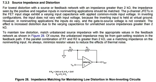

Beside the reasons that have been mentioned (protection, stability, ...), I want to add a possible reason: some opamps require that the source impedance of both inputs be matched to reach the lowest possible level of distortion. This is for example explained in OPA134 datasheet:
So the resistor would be there to match the other input's impedance.

Having a 100K resistor in series with the input would do a lot to make the circuit very rugged against transient input voltages that go far beyond the supply rails.
It's a technique I commonly use to harden stuff in harsh environments.
That's at least one plausible use for R1 and R2.

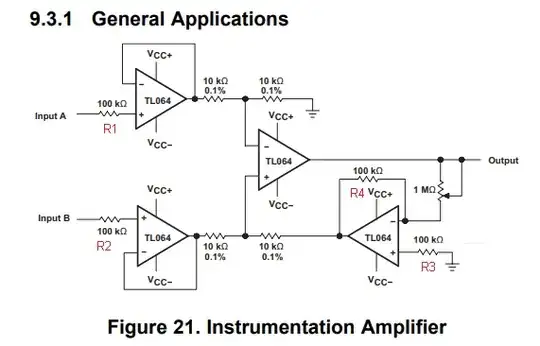

As for R3, matching R3 to R4 reduces offset due to input bias currents, provided that the bias currents on each pin are matched. Its not a perfect match however since the input impedance on the inverting input is 90.9K not 100K (but it's better than nothing).
