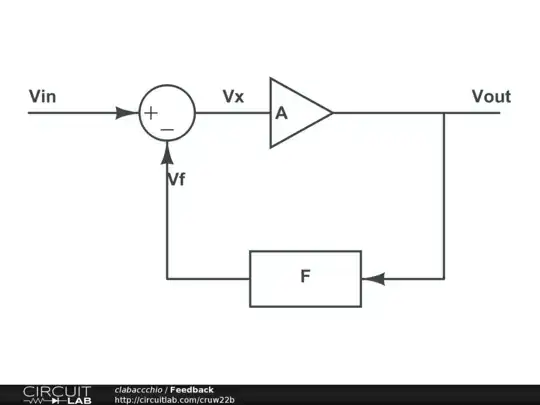

The ideal op-amp has infinite gain, and this is of little use in analog electronics. The feedback is used to limit the gain of the circuit. You can find many examples in the wiki article.
Consider the simple feedback loop:
\$ Vout = A \cdot Vx \$
\$ Vf = F \cdot Vout \$
\$ Vx = Vin - Vf = Vin - FVout \$
\$ Vout = A \cdot Vin - A \cdot F \cdot Vout \$
\$ Av = \frac{Vout}{Vin} = \frac{A}{1+AF} \$
In the case of the op-amp, its gain defines A: it will be a quite nasty function, because these amplifier are made for just giving brutal gain, and won't have a nice linear function. Luckily, if you look at Av, if A is big enough it will cancel the 1 and itself leaving 1/F to determine the gain.
In the case of the non-inverting amplifier, the block F is a voltage divider, so it will be something like 1/X. This will set the gain of the amplifier to X.
In the case of real op-amps, A won't be infinite, but big enough to allow cancelling it in the DC gain equation. And the advantages of feedback are even more, like increasing bandwith, linearity, S/N ratio and more. For instance, in a closed loop the gain is determined only by the inverse of the feedback gain, provided that the op-amp gain is big enough.
Actually, one resistor only is not that useful as a feedback, as it behaves the same as a short circuit. A voltage divider to ground makes it behave like a fixed ratio multiplier of the same factor (for the same reason mentioned above).

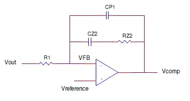

A typical power supply error amplifier has no DC feedback path:
Sipex app note  - error amplifier
I can assure you, however, that this amplifier works quite well.
Visualize this error amplifier controlling a buck converter. Vcomp would be used to control the duty cycle of a switch, which controls current flow through an inductor and controls Vout. As Vcomp increases, so does the duty cycle, which causes Vout to increase and Vcomp to decrease. The compensation network will increase or decrease Vcomp in a controlled manner, to force Vout to match Vref (as closely as the opamp will allow).
[ Of course, the power train is providing some semblance of DC feedback, but I digress :) ]
Adam Lawrence
  • 33,161
  • 59
  • 110
    I think you are overcomplicating things trying to find an exception to OP's answer, especially because he's asking about feedback (try to abstract from him mentioning a resistor) and your circuit actually HAS feedback, but only for AC signals. – clabacchio May 15 '12 at 22:01
    The circuit depends on DC feedback also. It's just not shown in the circuit. The circuit shown is not the complete amplifier. Vcomp controls the duty cycle of a switch which then controls Vout, and this is effectively a DC feedback path. There has to be DC feedback, otherwise what will stabilize the amplifier? The AC local feedback will not do that. – Kaz May 15 '12 at 22:40
